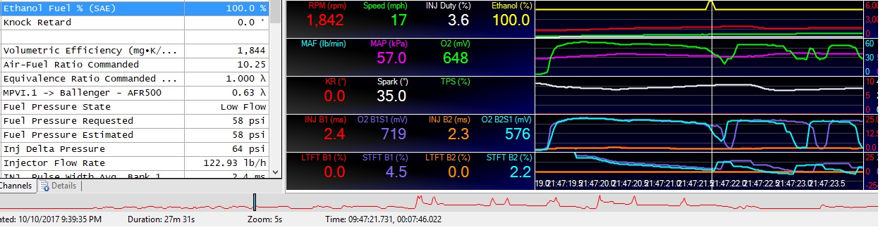

Flex Fuel Saga Continues.
Well, new position and sensor did not solve it. I did a run tonight -- logged again. You can see the signal coming and going here (this really shows how its coming and going):

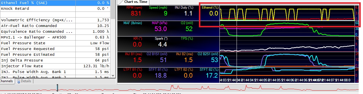

Also had some '100%' readings too:
Now, this is just barely moving -- so the signal coming from the sensor is oscillating and the ECM is doing its best to keep up.

Your commanded EQ is the same no matter what your sensor reads. Doesn't look like the issue is affecting fueling. Not in those pics anyway. There is a setting in the tune I believe, that adjust the rate of change for the alcohol EQ. Apparently your settings are slow enough your ecm doesn't react to it. I wonder if it's really worth worrying about.

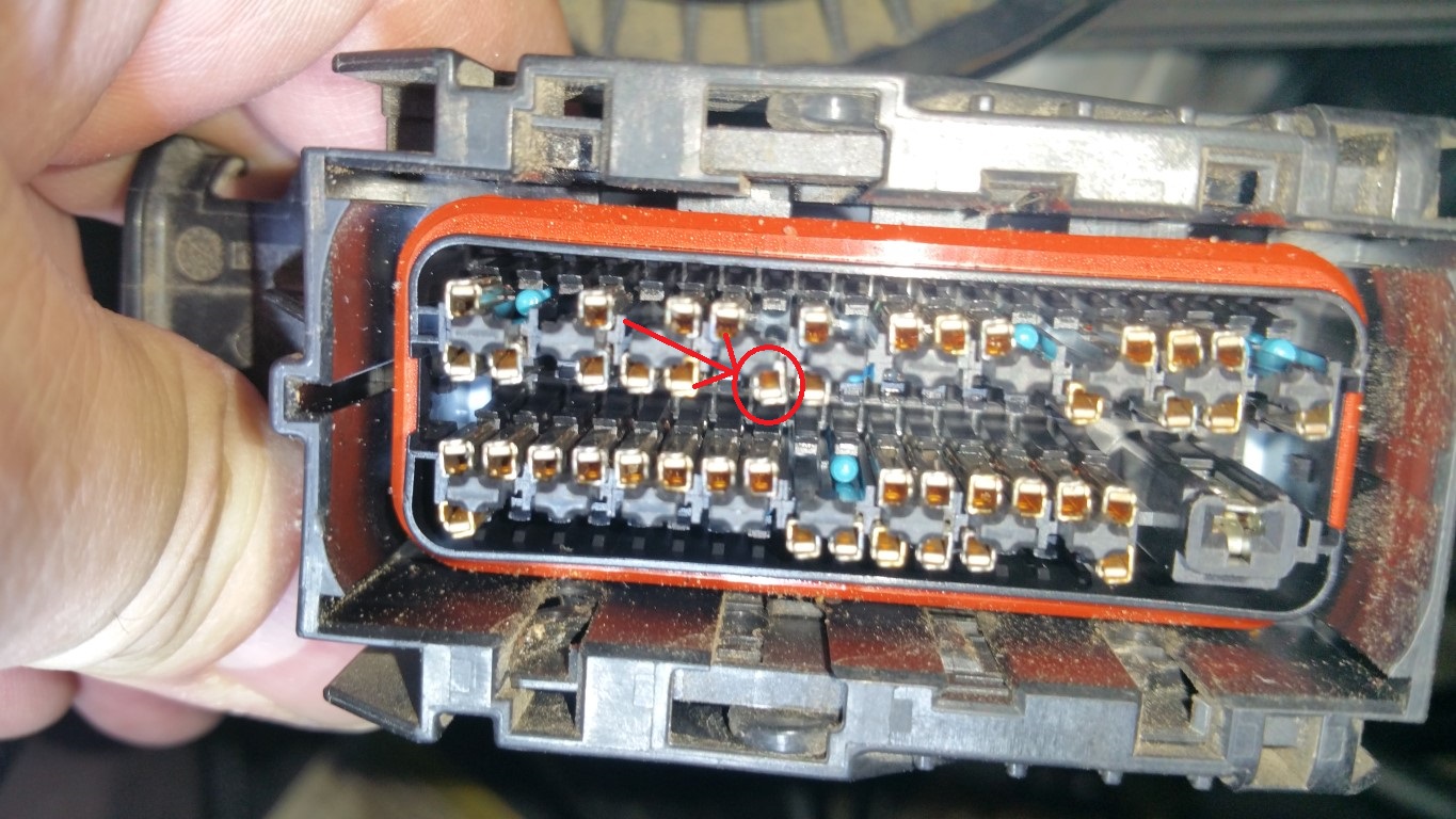

And, is the pin on the white wire oriented correctly in the plug? It does matter which way it goes. Just a thought.

I double cked the white wire before replacing the harness and it was correct:

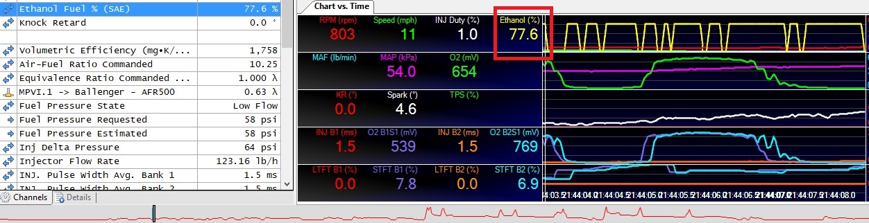

Yeah, that oscillating doesn't appear to be impacting the constant reading, and it is at low speed too... I added it to the output so I could look for trends. It's happening so fast, I doubt, like you said, it's a problem.
Now that I have the new harness on, we'll see if it makes a difference. This data log was from the previous harness.

Still the same -- its as if when I get the speed above 70 and RPMs up, the ethanol goes to 0, then recovers when I let off.
So, new sensor, new wire harness, same problem. I'm going to verify the 'ground' is still good, but after that, I'll be making my own harness with its own power source. Outside of a loose ground, I don't see anything else.
