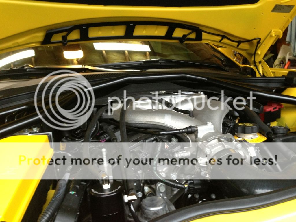

No problem. A heads up the elite can on the V6s works best with the LFX bracket. They normally include a L shaped bracket for the LLTs and on the LLTs that radiator bolt never really catches when you attempt to install there. I was originally included the L bracket and when that didn't work they sent me a LFX bracket right away and they said they were contemplating on changing the LLT cans to include the LFX bracket as well. The LFX bracket mouts to the engine cover stud
always wondered if they fixed this. should just include a longer bolt...
Old 04-22-2013, 12:55 PM   #1684
menendez1293
Emerald Coast Camaros
menendez1293's Avatar
Drives: 2010 Camaro 2LT/RS M6
Location: Tallahassee FL
Posts: 9,686
A longer bolt can be a fix but you have to find the right length where it wont have a chance and go through and hit the radiator. The LFX Bracket is by far the easiest way to fix that issue.
does the engine cover still work, with the lfx bracket? never seen that bracket, and how it works.
edit: and I would think you would need a bolt that's the same thickness of the bracket, added to the existing bolt, would work perfect. for instance, if the stock bolt is 1 inch long, the bracket is 1/8" thick. then you would need a bolt that's 1 and 1/8th long.
Old 04-22-2013, 02:22 PM   #1686
menendez1293
Posts: 9,686
I personally have not tried to put the engine cover back on after the elite install but I had my RX can in the same place and never had an issue. Here's a picture to show how the Elite can mounts. I think if I had a problem it would be due to the lines and not the can itself. But it's fine with me since I hardly ever run with the cover on.

My husband riggged up mine with a small piece of aluminum he cut 2 holes in & fasened it to the radiator hole then fasened the V6 Elite bracket to the piece of aluminum. They initially sent us the wrong bracket & we did not realize it until we had already disconnected everyting & cut the tube for the install. So we temporarily attached it at another location & that was also fine but it sat a bit lower in the engine bay. I will have to look for the pics of both when I get home & can post them up.
