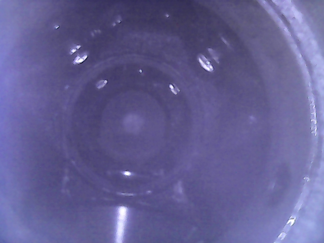

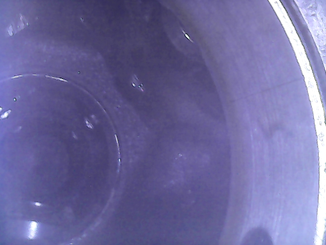

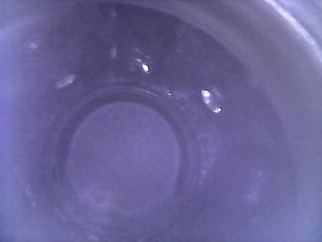

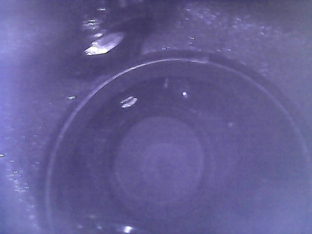

Thanks for taking the time to do the write up, My dad and i got alittle curious when the 5/16 sticks were inserted so we used his borescope camera to look into the cam journal. I read that some recommend to replace the cam bolt if you stay with the single bolt as i did (custom grind). Thanks for all the info, here are our pics.
