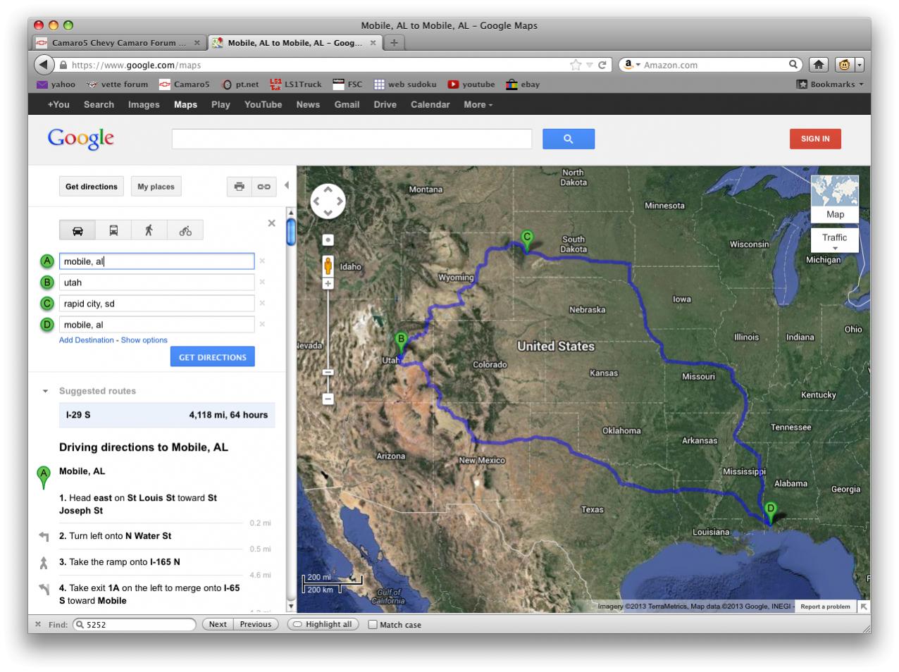

i'm surprised nobody's shown this yet with all the talk of blower efficiency on xxx cubed engine. i'll warn you, it takes some post-elementary math to figure out the CFM number to use, but once you find out how much air your target engine will move (through cylinder volume, compression, head flow, etc), this chart will show you the target boost level to shoot for & what RPM you have to turn to achieve that.
Originally Posted by IRPQ View Post
Hmmm....... I just don't like the sound of the cog drive.
Might have to just do the 8 rib. $$$$$$$
I assume Ted has a 8 rib pulley for his supertensioner.
or you can drill a couple tiny holes into the cog valleys to quieten it down (which, with a big thumping cam, i don't see why you wouldn't want a little whine to augment it).
from what i understand, the sound is created from the air being compressed into the valley by the belt, and if you alleviate that pressure, you lose some of the sound. that's what i've seen on a couple cars, anyway.
that way, you get the quiet, wussy-sounding operation & get to eliminate any rear belt slip - which, as Jamie mentioned, starts becoming an issue above 10psi on the factory 10rib rear.
then there's also the gargantuan LPE 14-rib contraption that also works quite well & has it's own independent tensioner to keep the strain off the jackshaft. it just requires a lot more room & money than a cog setup.
either way you choose, if you're looking at 10+psi, you might need a 8rib front drive anyway. i know i was slipping a good bit @ 11psi with my stock 6rib
In the coming weeks I will know. I have a trip to Utah this next week so the week after I will get with Livernois and begin this build.
not that far out of the way...
just sayin'

haha, I'm flying. Leave here in about an hour to head to the airport. I'd damn sure stop in and see you guys.
