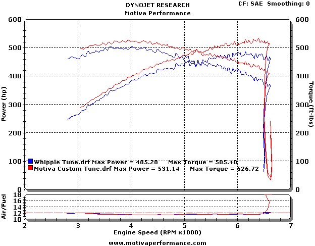

Whipple, Kooks 1 7/8 headers and sleeper catback
Guess I never posted this here. I did the install Dave at Motiva did the tune.
531 Horse, 526 Torque
Attachment 189782
Pretty Awesome to see you not only making more power than the other SC applications, but also a couple in there with SC's AND Cam!
Nice work there sir!!
