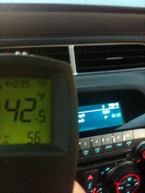

Originally Posted by i007spectre View Post
Went to my local dealer today, not the one i bought my car from. They told me that if the freon was low it would pop up a light in the driver information center. They also said that you cant check if its low, the only thing they could do was empty it all out and then refill it from scratch to the recommended level. I called bs immediately and left quickly. Ill just go to my dealer, who aren't hillbillies. Although it has felt colder on it own lately.
Of course they can. That said, the easiest test is to simply measure the temperature of the air coming out of the vents. I read somewhere it should be 45 deg but don't take that as the Gospel truth as I'm sure 110 degree AZ heat is different from 88 degree NY heat. Most likely it's supposed to be able to achieve a temperature drop of "x" degrees from ambient temperature down to as cold as "y" degrees. Someone in the know, please chime in with x and y figures.
If you turn on your a/c in the middle of a 20 degree below zero arctic blizzard would it actually warm your car?
trm0002 is offline   Reply With Quote

So... I grabbed our Fluke temperature IR gun from work and tested mine this morning. As you can see, mine was blowing at 42.5 degrees with an outside ambient temp of 75. Good? Bad? Can't tell you because I don't know what the drop is supposed to be or if it will maintain low 40's when the outside temp climbs to the mid-80's later today. Rest assured, I will measure it again then and report.
no, because the compressor will not run at all...they have a low ambient temperature cut off, the fan will run but that's all you will get. GM cars have been that way for many many years.
