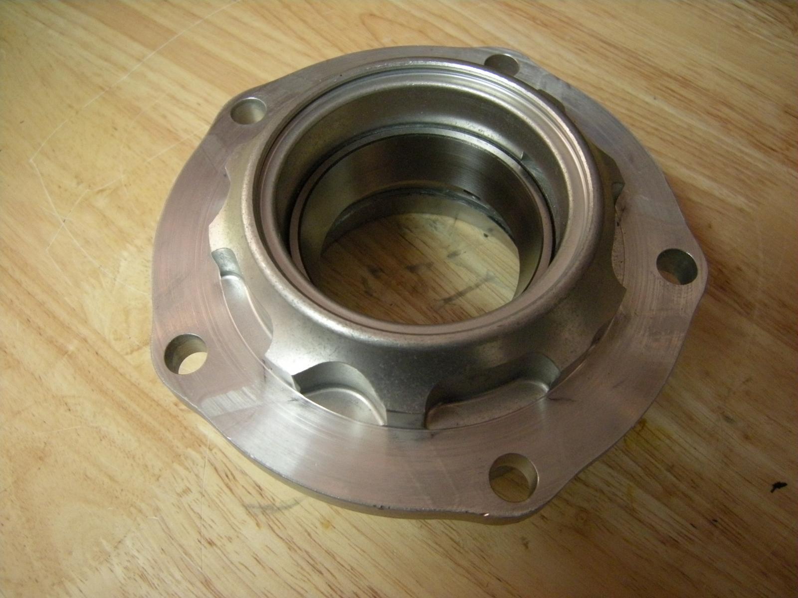

Back to Pumpkin stuff now that Warriors run to the RBC Cup is done. Spool and gear set arrived yesterday.

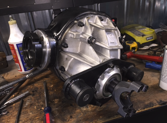

Got a call from BDS today my new 9" is assembled and ready to go.
Old 06-09-2016, 09:47 PM   #1811
Merc
In The Circle
Merc's Avatar
Posts: 11,310
9" 457 stuff back from BDS today.

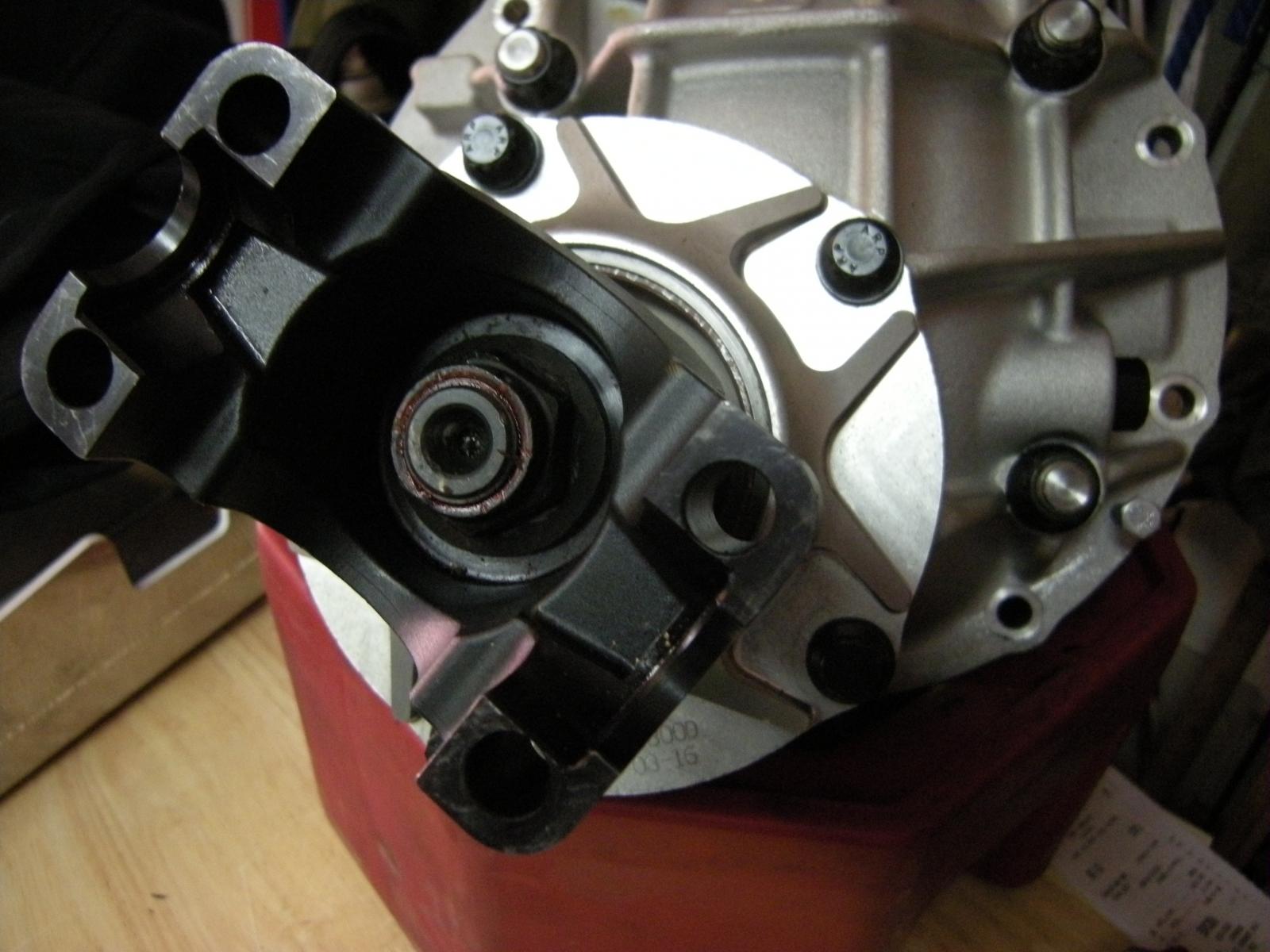

BDS did the swap of the Daytona support and while they were torquing the pinion nut this happened.
Name:  broken pinion.png
Now it looks like a long drawn out process with Strange and US Gears for a refund on the gear set. BDS not a fan of US Gears put a set of Motive Performance gears in.
