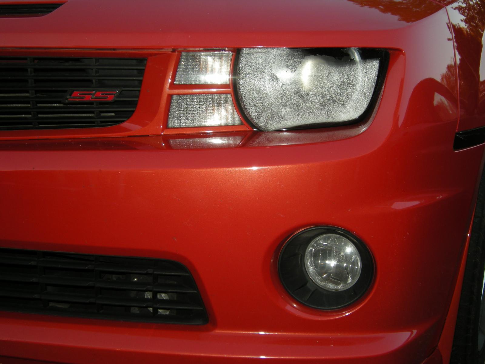

This SUCKS!
$800 to replace the RS headlight. That sucks it's cutting into my fresh set of slicks for the fall DA fund. Early spring weather up here was wet and I had to do the 9" diff swap back the 370 street gears without a trip to Sreet Legals this spring.

What happened to that headlight?

Some how it gets moisture in it. Not sure how, I don't drive Pumpkin in the rain just a hand wash does it. Just ordered a new one from Rogers.

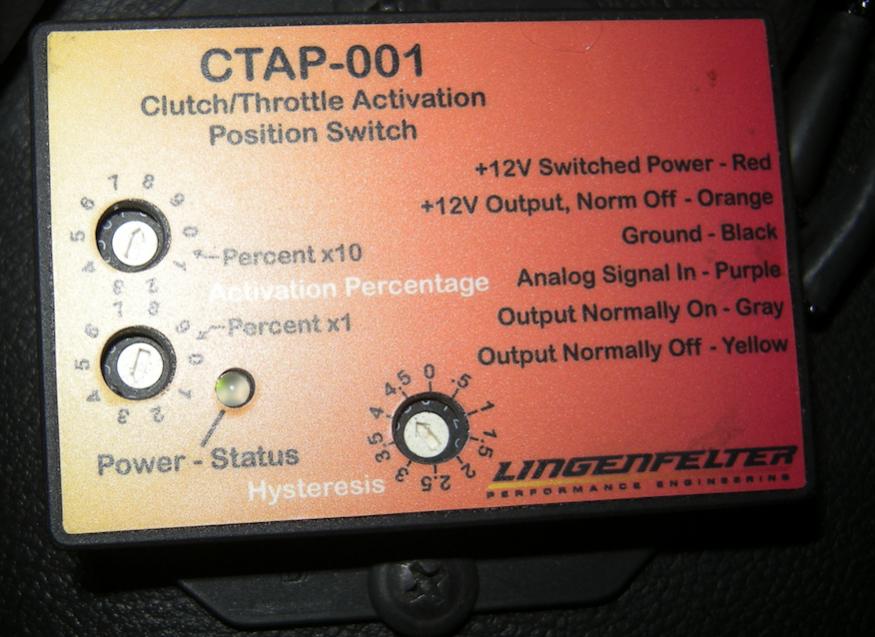

2-step Info
I get a lot of PM's in regards to the Lingenfelter CTAP and 2-Step so I thought I would share the info and set up, not that I havn't in the past. I launch Pumpkin at 4800 and 1.58 sixty foot is the norm with the 4.57 DSS 9"spool setup. With the 2-step you simply and quickly lift your foot off clutch pedal, no feathering it.
These are the CTAP settings I am currently using.
PLEASE NOTE: I'm using a DSS 9", shaft, axels and the stock diff will not stand to the M6 abuse that I currently mead out. I killed a couple dead over the years. I have know idea what HYSTERESIS does other then the setting you see seems to work for me.

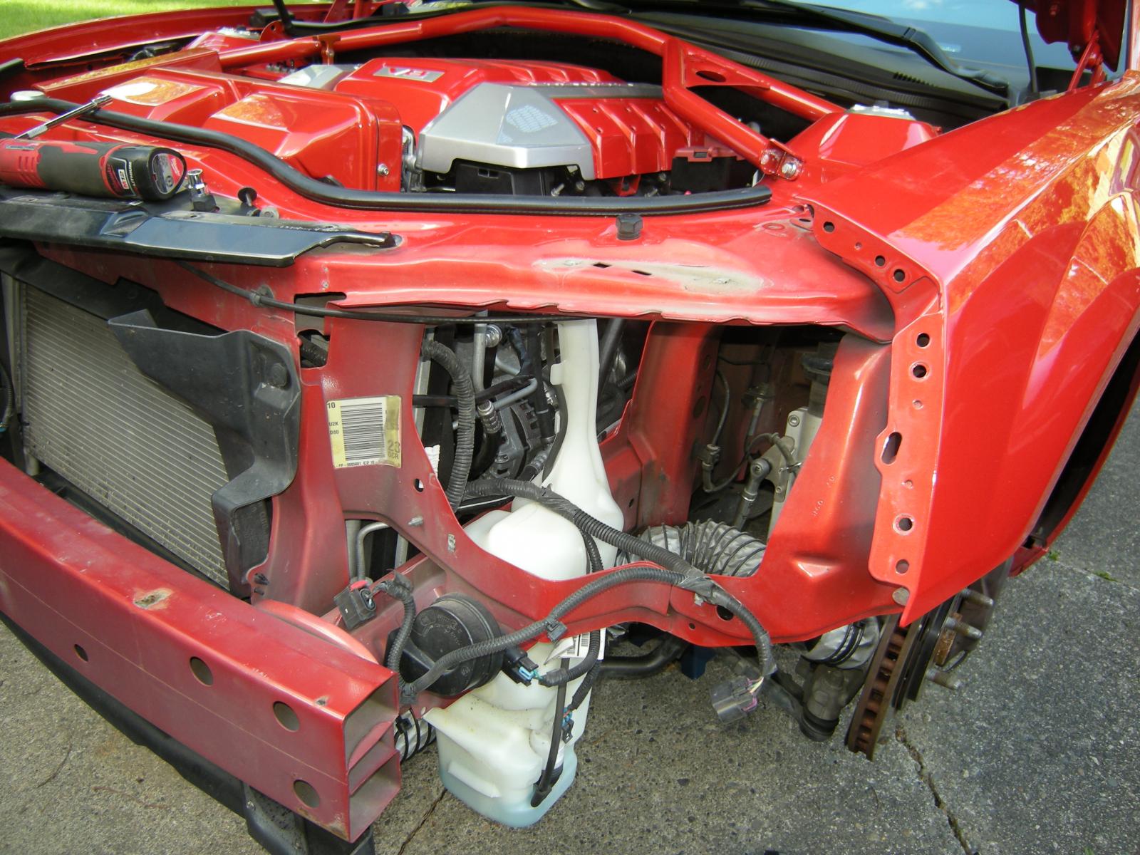

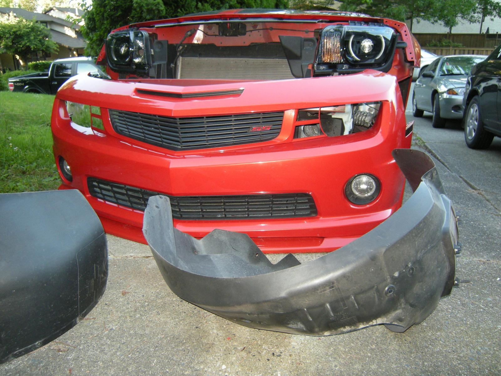

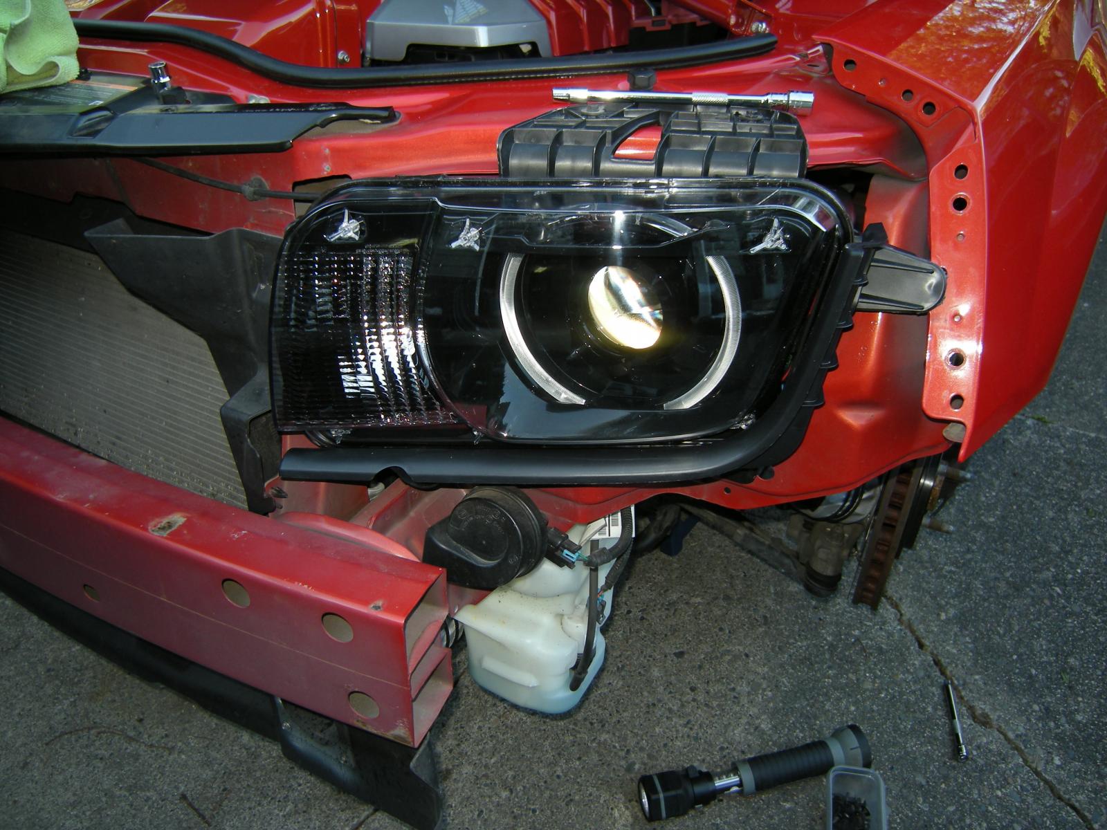

Headlight Replacement
Got Pumpkin in a hundred pieces today. Just got to wash and scrub the inner fenders and wheels and put it back together tomorrow. I suspect the water is getting through the rear headlight bulb access port. Being that I don't use the drip trays with the Hex vents I suspect thats the issue when I wash Pumpkin. Considering a bit of black silicone to back up the o ring.
