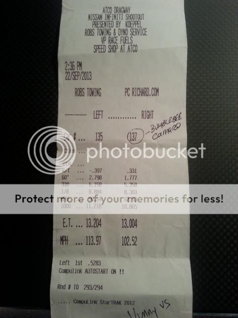

Ran at Atco this past Saturday and here are the times.

Nice Run, that is a really good 60' too. Looks like your trap speed is down a few mph for that ET, any thoughts on why?
I will post your run to the front page, this puts you at # 5. Congrats.

Tires used on the pass: Fronts- Stock 19" Rears- 18" Nitto NT05R 305
Performance Mods (if any):ARH, Injen CAI, Trifecta NOS Tune, Nytrex 100 shot, SS Posi rear with 3:45, stock exhaust, black isolator, ported TB, 3400 TCI converter, SJM line-lock.
Transmission: A6
Category submitted for:
R/T........... .331
60'............. 1.77
330'........... 5.38
660'........... 8.303
660’ mph... 82.93
1000'.......... 10.865
1320'.......... 13.04
1320’ mph… 102.52
Name of the track: Atco Raceway (Atco NJ)
Date of pass: 9/21/13
Weather conditions (include Density Altitude, if known - DA can be calculated by going to http://www.dragtimes.com/da-density-...lculator.php):
Sorry couldn't figure out that DA #.
Don't know why my speed was down at end. Open to suggestions??
FrankieBee is offline   Reply With Quote

305s may be too much?

Working on going smaller, 16's hopefully (rim size).

Are there any 16s that'd fit? You might want a little less width too. Like a 275-285 radial

Thank - you for the updated information, I will get it posted today. As for the DA, I can get that info. for you.
Now posted to the main page, Congrats.
DA was 885.
Could be, I tried those and found them to be just to be and heavy for our V6, way more tire than we need.
I would try the Mickey Thompson Drag Radial. Go with the 265/40/18. This is what I am currently using. Get the benifit of a gear change with this since it is a smaller dia. This is plenty of tire for us. I bought the set-up used from a friend who was running a modded SS, and this was plenty of tire for him too.

Yea but he's also running a 100 shot of nitrous so he may need that much tire. Of course I don't run nitrous so I can't say for sure. But I'd definitely do the 16" wheel route if you can

My point on the tire I am running thou is his 100 shot + his HP is no more than the SS that I got my tires from, and my friend hooked up with NP with that set-up.

Picking up a set of CCW 16" wheels with Hoosiers slick. They will fit when I replace my brembos with my stock V6 brakes.
