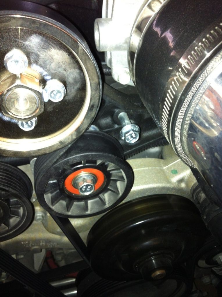

pierre777
HT5 COTW 9/3/2012
pierre777's Avatar
Drives: Cyber Bullet
Location: lebanon
Posts: 4,555
ok sorry for the late pic as my photobucket acc was stuck, here's the pic of the bolt we used no need to pry against the throttle body.

It's going to even up anyway. Start your engine and watch the tensioner bounce. The belt is going to settle in with even tension on both sides of the blower pulley no matter what.
To only pry on the idler is crazy. It's a lot of pressure on the pry points for nothing.
I disagree. The question is belt wrap not tension. It obvious that an automatic tensioner would even out the tension on both sides of the pulley. It's an automatic TENSIONER.
Let's get back to helping the OP with his issue.
