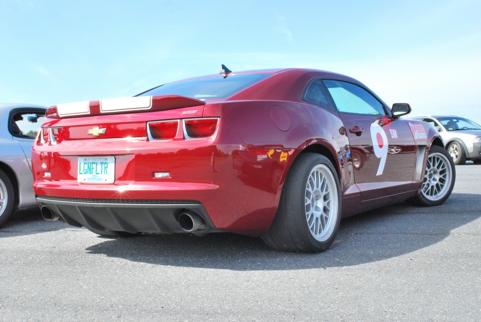

Originally Posted by 600hp-lpe View Post
Pic's at the end of this post show the clearance issue with an 18" wheel.. see how close the
LCA (Lower Control Arm) is to the rim? the marks in the 2nd picture on the LCA are from
the wheel biting into the arm.
I worked with John at CCW for 4 months to come up with the correct offset for running 18's..
but there just isn't enough clearance for them on the street, even with the correct offset/backspacing,
you still have to modify the LCA to make 18's fit and not rub.. I replaced the Lower Control Arm with Spohn
arms and we modified them to have a 1/2" cut in them where the wheel needed clearance.
They are killer for the autocross track, though. Makes the car like a skateboard with the short tires. With an 18" tire
on the street, you will have issues bottoming out on speed bumps and driveway crests.
Here are the 19X10's I run on the street..
My car at an autocross on the street tires.
Here are the 18's mounted on the car for the autocross track...
Notice how LOW it sits, just with the short diameter tire. The car only has 1" drop in suspension. (Tire diameter measures 25.6" tall)
Here's a pic at one of the SCCA Autocross events near the end of the season.
This is the definition for Sick Camaro!
