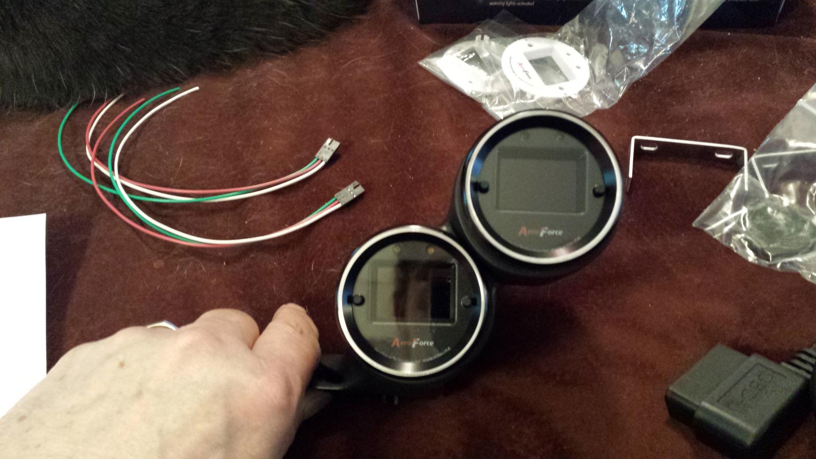

My gauges are here but my car is not.
Don, what sealant did you use to close up the hole you drilled in the plenum? Aerotech included a patch of what appears to be duct putty to seal the pod off.
Would be nice if the pod had a set screw in it and possibly a detent notch in the gauge housing to help keep it dressed and covered and secure. Ah well. Will manage as you have Don
_______-2015 1LT JUSTICE----------------------------------1997 B12-___________
