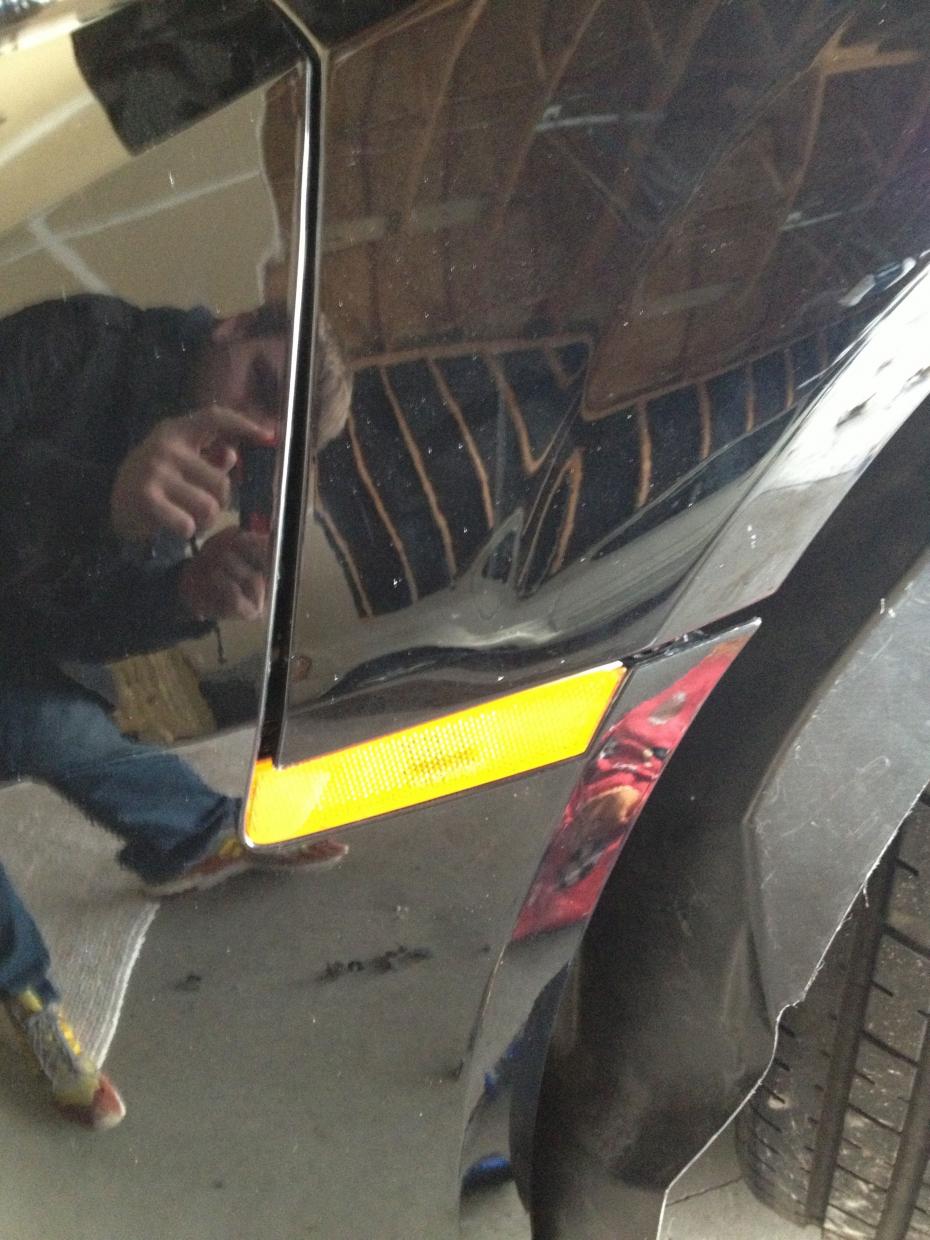

Originally Posted by chathen613 View Post
So i am not able to get the bumper to line up properly on the sides..it's really noticeable at the driver side turn signal. Will it line up as I start screwing everything back in or is this wrong? Any suggestions?
Attachment 474819
Make sure the guid pins are lined up to the wholes in fenders. if those are lined up and the bolt near the side marker is lined up, you should not have that gap. Watch Part 2 @ 6:30
So I finally did get it fitted correctly, after jacking up the front end and taking the wheels off.. Turned out the air scoop i had installed earlier was also getting in the way, so i had to take that off, and reinstall it afterwards. In conclusion, WHEELS OFF FOR MUCH EASIER INSTALLATION
Attachment 498203
Nice. I'm glad it was something simple.
