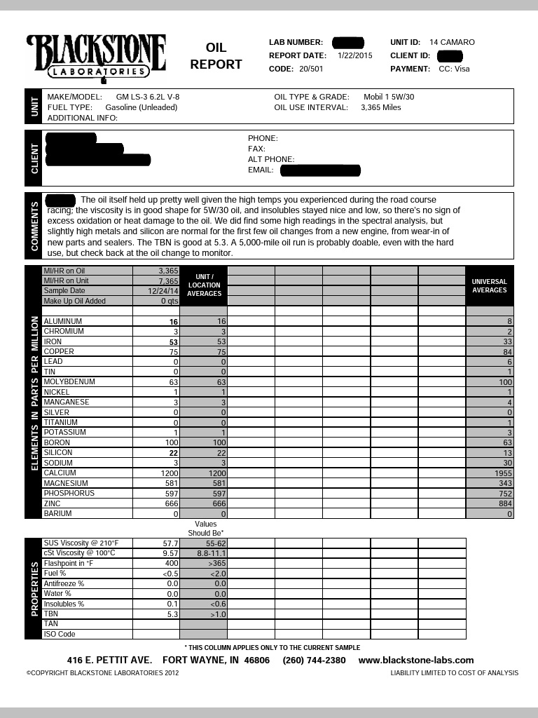

Here are my results using M1 5/30. The oil is holding up well to the heat. In this sample the oil temp was running at about 290. I switched to M1 0/40 this season and I've noticed higher oil temps, about 310, we'll see how that looks when I send it in for analysis.

Here is the last report I did. Has 2 track days at TWS the previous May. As I recall oil temps got to third tick mark. The total miles on the car were 24,666 (not 74,666). Oil: Pennzoil Euro L 5w-30. The high viscosity is reflecting the high HTHS (3.68) of this European spec'd oil.

While I am thinking about it...the single biggest contributor to poor oil reports in my years reviewing them on bobistheoilguy.com was not oil viscosity, brand, etc.
It was DIRT! Ie silicon levels were high or even a little high. So be careful with less restrictive filters and poor fitting CAI systems. If you open the engine consider an immediate oil change afterwards.
