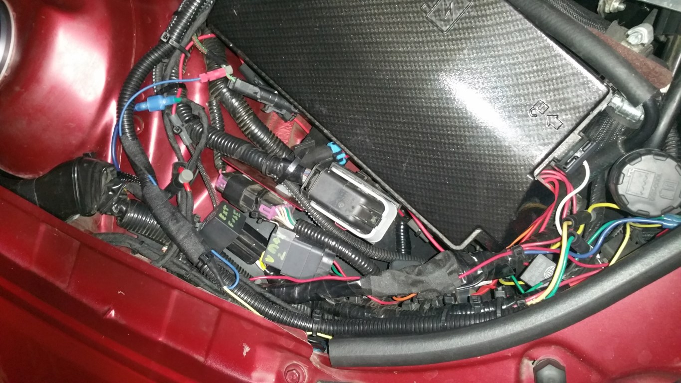

OK, I extended the wire so I can tap into the MAF Hz wire:
Now, normally the 'yellow' wire on the MAF is the Hz signal:
I have an Hz test meter coming in today to confirm that but, that is the wire I intend to tap into.
So, I had to reset the controller to use the 2k Hz to 14k Hz settings:
Manual here:

Alright! Tapped into the Hz now that I've verified the Yellow Wire is Hz output:
Here is how I validated I had the right wire:
Prep and Test!
LED and status on the controller now flash 5 times (mode 5)...
Now, onto the LID!
