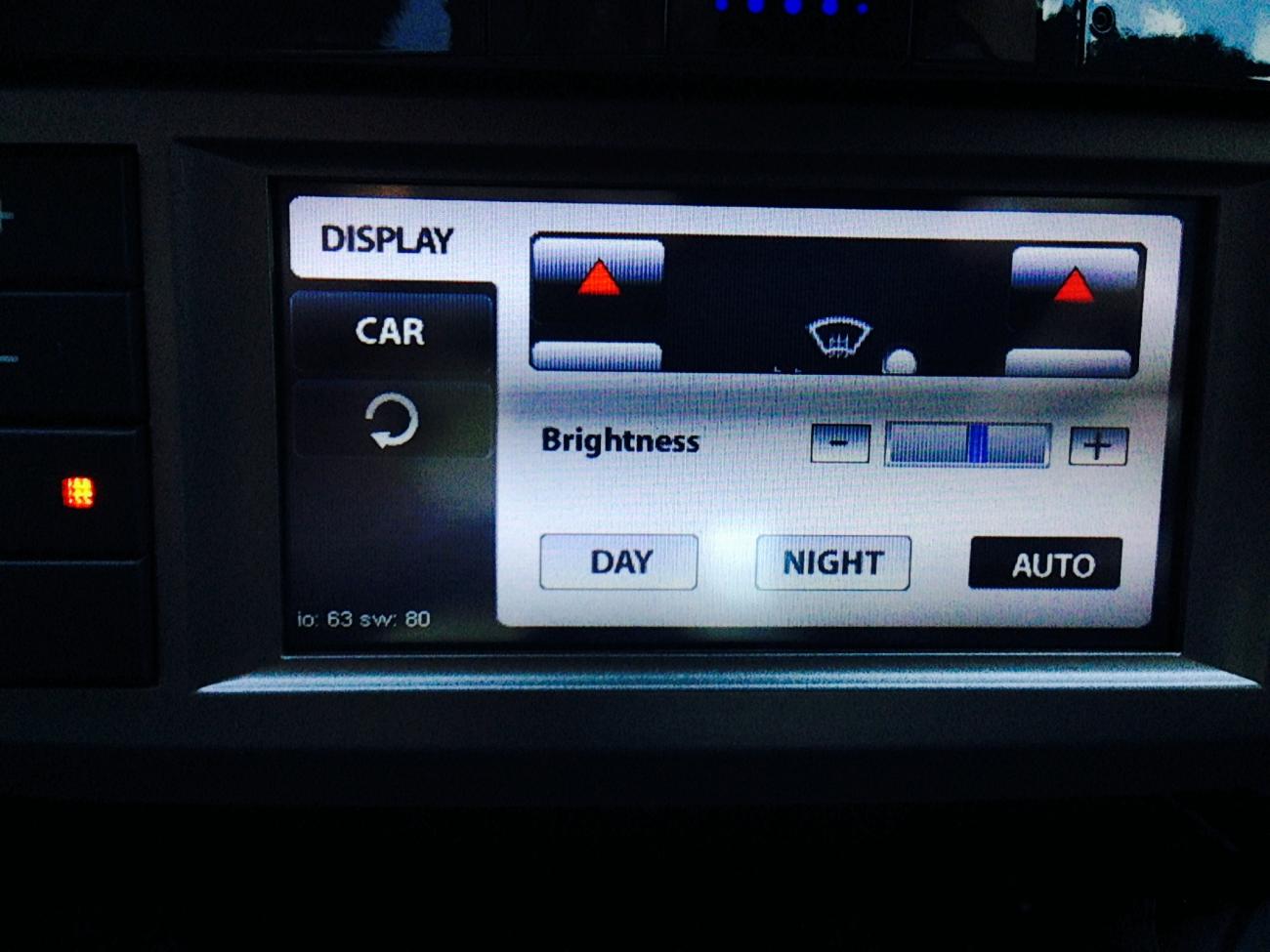

After 96 hours installed, the tire warning has gone away. This kit itself works perfectly, just seems to be interfering with something in the car. When the tire warning was popping up, it was the passenger rear tire that it was not receiving a signal from. I have been on the phone with Scosche as well as exchanged emails from their tech support... here is a correspondence that I had....

ME:
9/12/13
How do I tell which version is running?
Scosche:
Press the set button. You should now be in the Settings Home Screen where you can adjust the display.
In the bottom left hand corner of the screen there should be a number indicating the software version your unit currently has (ie: io 48 sw 68).

After confirming I had the most recent version of the firmware.....

Just installed the Alpine unit last night. Immediately after i have issue #1. No other issues have arisen yet but time will tell. I am not sure i have the latest version of firmware though. I know how to check but how would i go about updating it if i am out of date?
You have to get ahold of Scosche and get them to send you the firmware via email. You would then update using a flash drive and the usb port located on the harness of the Scosche kit. I was told by their tech support that I have the most recent version. Here is a picture... the numbers in the bottom left corner of the touch screen are the software version.
I have the alpine kit. So i assume i would just contact Alpine to get the latest firmware. Thanks for the info. I will check my numbers against the schoche though and see if mine are similar.
