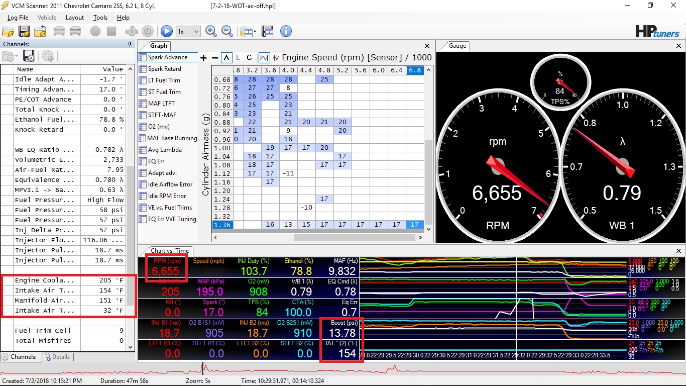

LSA ProMeth Install Test Cont.
Wanted to show the IAT2 temps using 50/50 Meth (Boost Juice):
Yes, almost 7K RPM -- I actually shifted @ 6500 and this time it was a bit slow to shift so I'll need to remember to shift much sooner...
Still, this really shows even spinning the blower that much, IAT2 temps are cool...
-Don

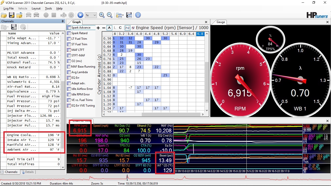

Here is a before pic:
That is about 25° more and ~300 RPM less -- boost is about the same.
All of this is before we adjust the Lambda for meth...
-Don

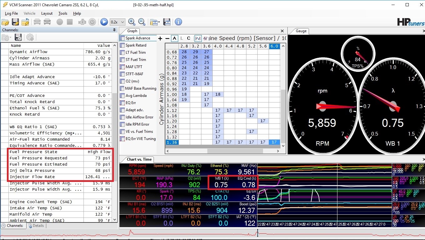

Mark and I touched up the MAF Curve up to 11,550 Hz (removed 2% -- From the logging, I don't get much above 10k Hz so this is a good stopping point).
I'll do another run when weather is not 'wet' and this should get me very close to done.
I think I'll leave timing alone for now and test this for a while before anything else.
I want the flow gauge in before pushing things -- just to be certain the 'on/off/on' of the LED is just a glitch...
Here is the log I had 'before' the new tune adjustments -- very close:

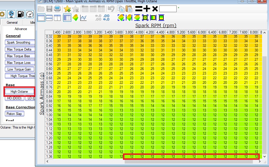

So, Mark took a bit of time to teach me how the 'timing' is setup.
Since I use E85 (or close), These tables determine overall timing:
High Octane (HO) Table -- sets the 'floor' of the timing (base if not running E-85 -- say just 93 only):

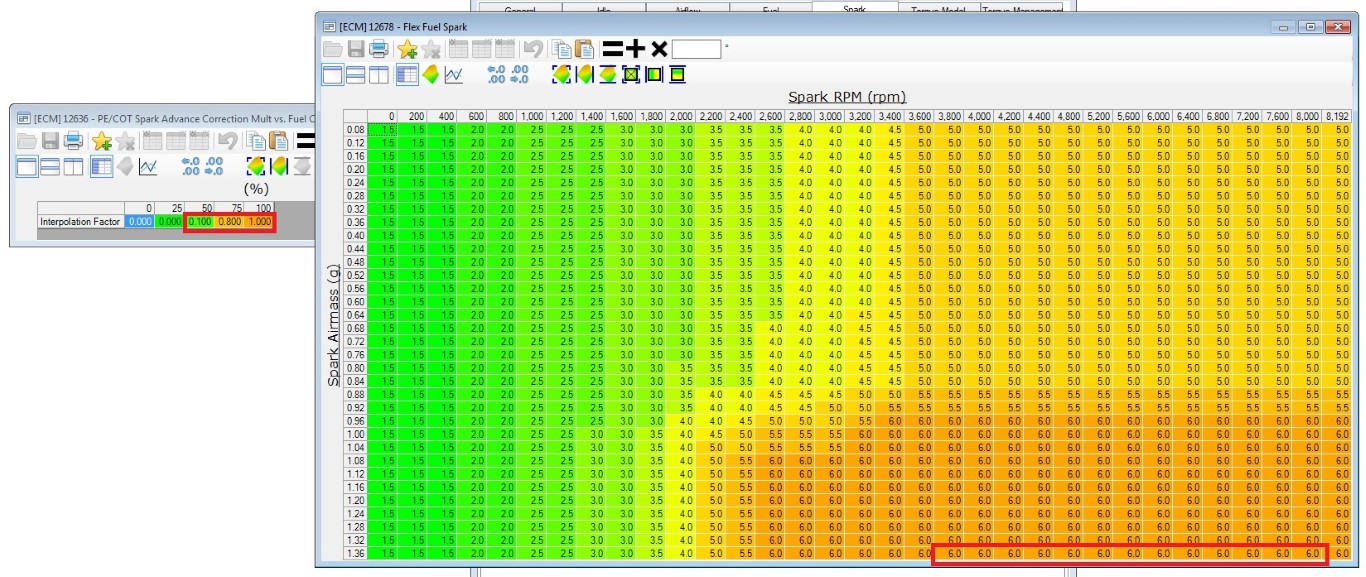

Next, since I'm running corn, these 2 tables come into play:
So, taking the HO spark (12°), then using the Flex Fuel Multiplier and the Flex Fuel Spark Table -- figuring on a 75% blend of E, we add this to the HO Spark:
Assuming a 5000 RPM, we will be using 12° @ 1.36 Spark Air Mass from the HO table, then .80 @ 6° from the Flex Fuel Spark table (same 1.36, 5000 RPM) and then multiply 6° *.80 = 4.8° (rounded up to 5°) so this is where the 17° of timing comes from:
So, when I decide to test the timing, I'll update the HO table in the 1.36 range only and do my testing there - in the 3400-6800 RPM range - per Mark’s suggestion.
