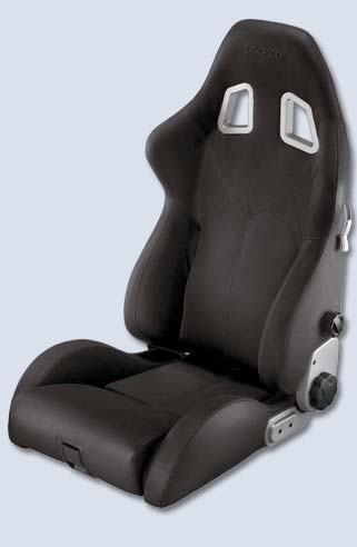

I have found the seats I'll be ordering pretty soon... Unfortunately they do not come in grey leather, but I'll deal with it... Seat image is below... It's the Sparco R700 MILANO PRESTIGE in leather...
