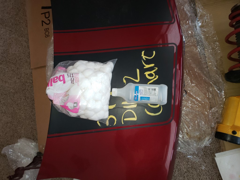

So, wanted to be sure I could get the boneyard's paint off. A little 70% Denatured Alcohol, cotton balls (Jumbo) and off it came -- took about 5 minutes to get the little I needed off:
Final wipe down and next the stripes removal...

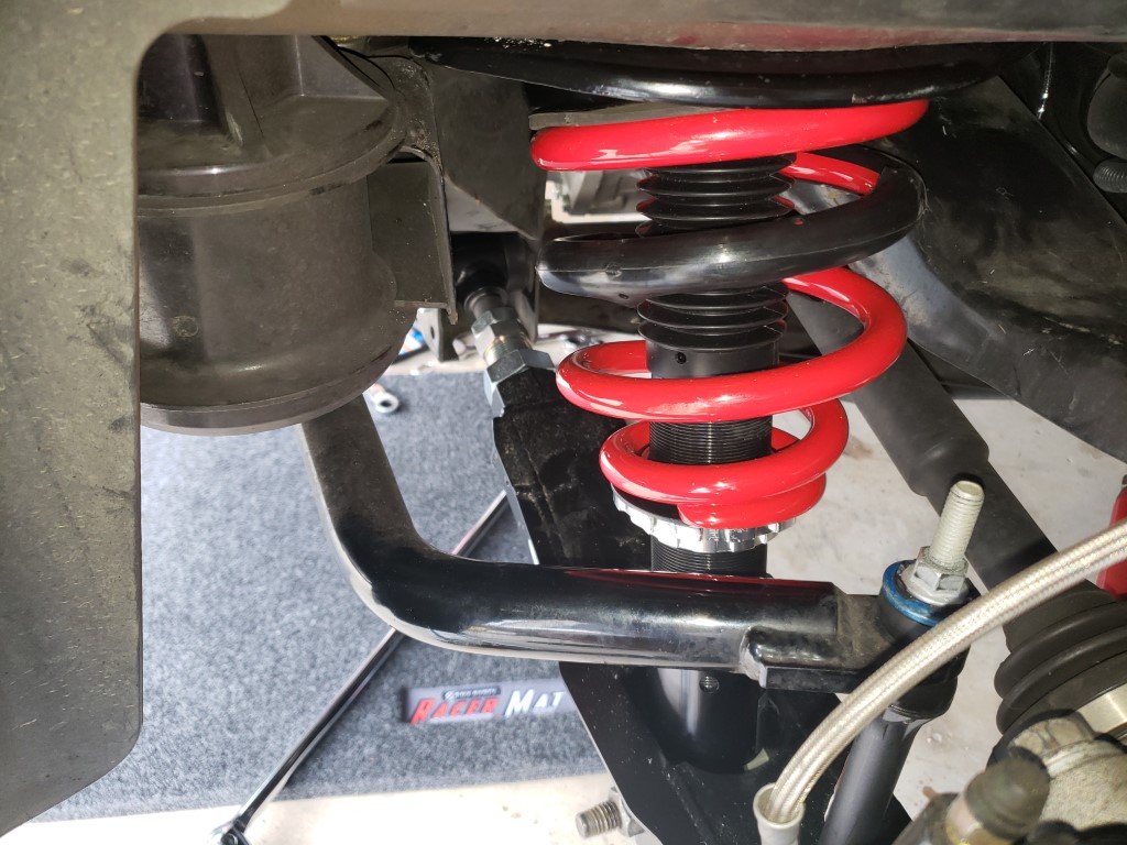

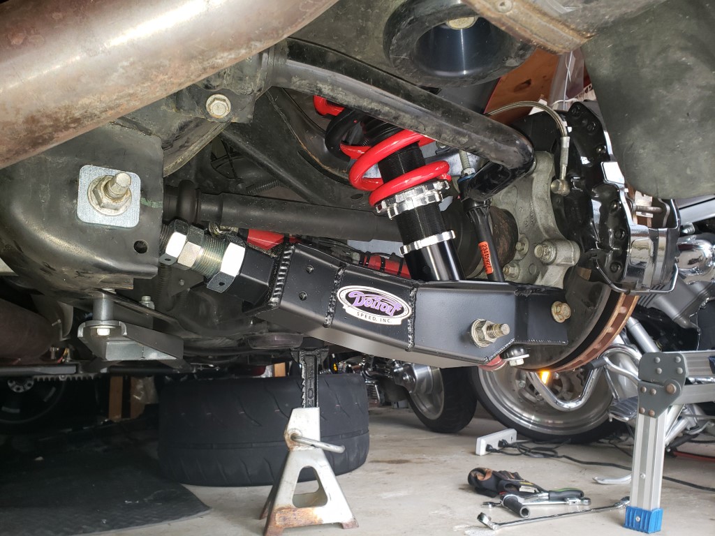

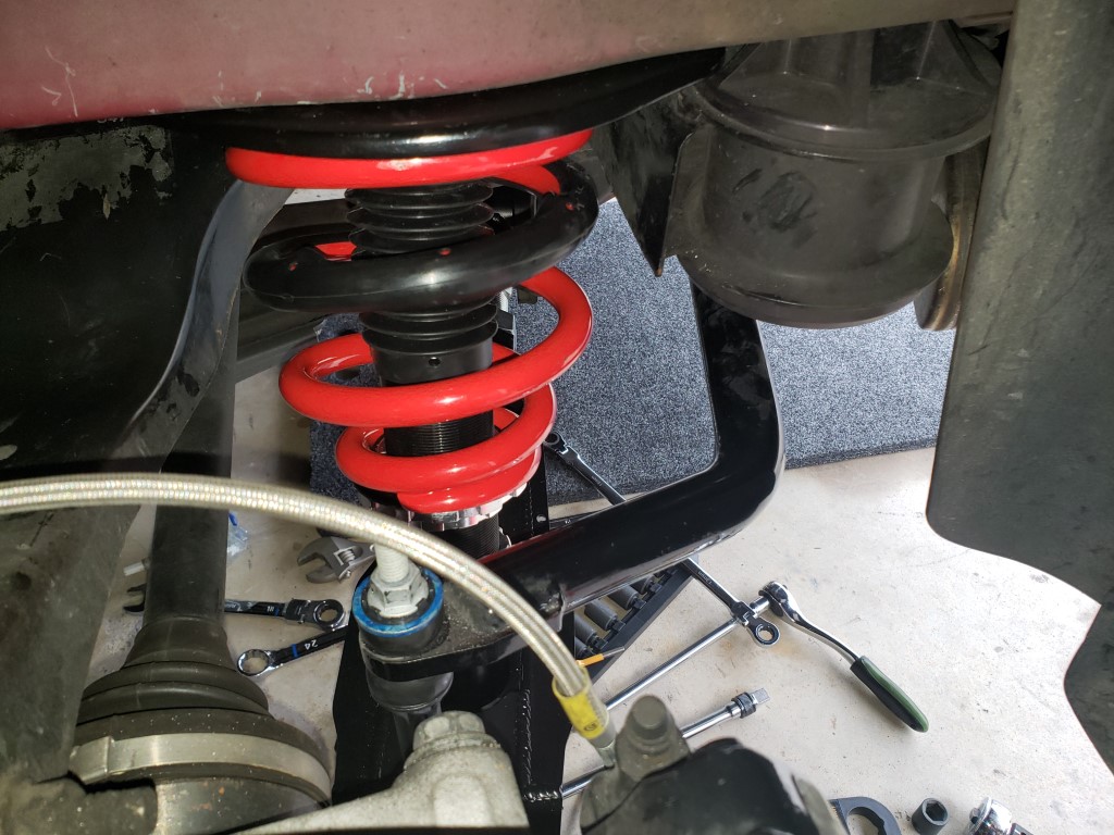

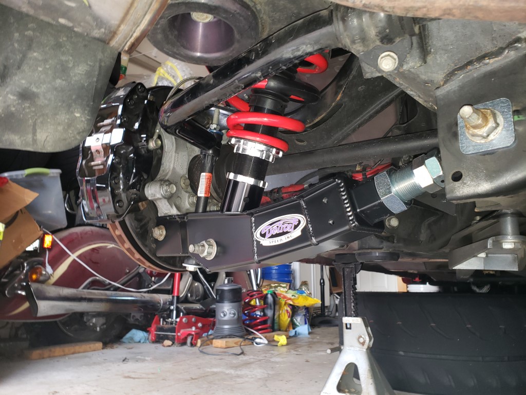

Pedders Cont.
Rears are done!
After adding some clearance to the lower coilover cap, everything lined up! I did have to keep the strut tower cap 'loose' so I could ease the coilover into the Detroit Speed LCA but, everything line up, used a jack to push things together and got everything 'guten tite' ;o)
New Swaybar links front and rear -- now we're talk'n!
Rear coilovers set to 14 from soft... Tested setting them from 'under' the car to make sure I could do it...
Next item is the bit of front end work I had left then 'alignment'!
-Don
747 RWHP 794 RWTQ

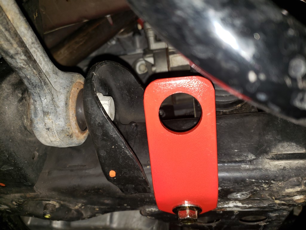

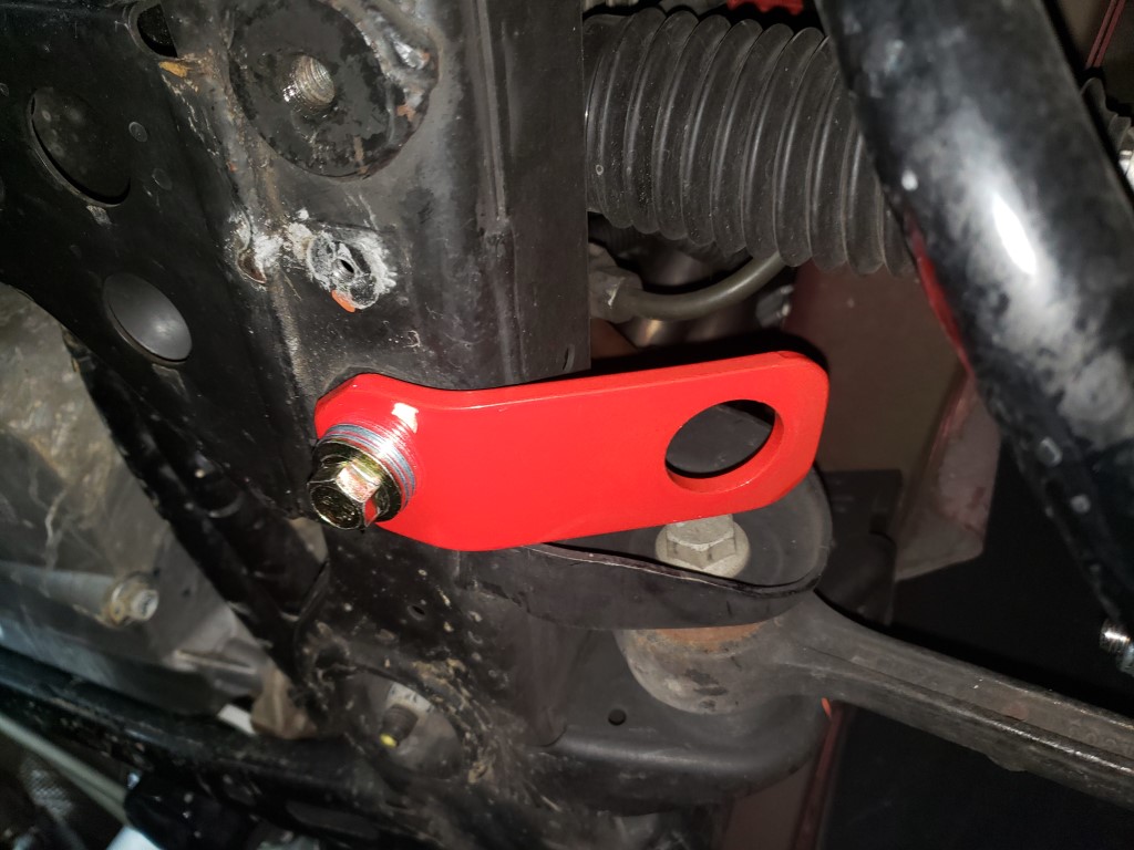

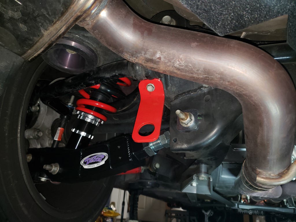

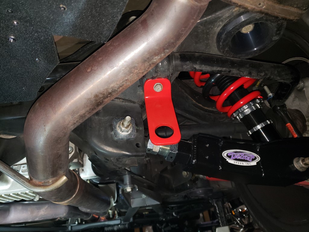

ZL1 Addons Strap Points
Got around to these finally, rears -- no problem:
Fronts -- drivers side:

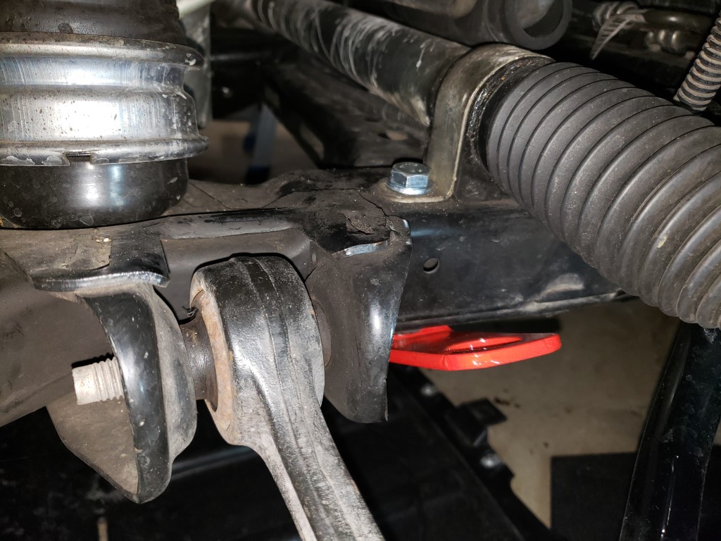

Passangers -- and -- what?
Yep... Rack bolts take up all of it...
So, looks like I have an extra front for now.... Have to see if I can find bolts for the rack that are shorter -- maybe a 2013 will do (Electric Rack)
Figures...
Draining the radiator hose so I have a bit of cleaning to do still... yuck...

ZL1 Addons Strap Points (cont.)
Problem solved. Got a M12 1.75 x 60 MM with a washer, did some blue locktite -- done!
next some cleanup and validate/adjust the ride height -- then alignment. I'll do the caster plates and motor mounts later since I have a race coming up on the 23rd of Feb and I need to do some track prep for that...
