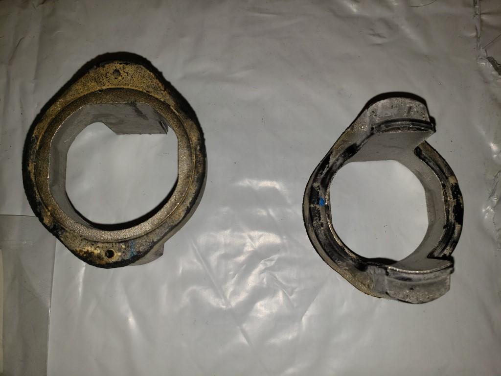

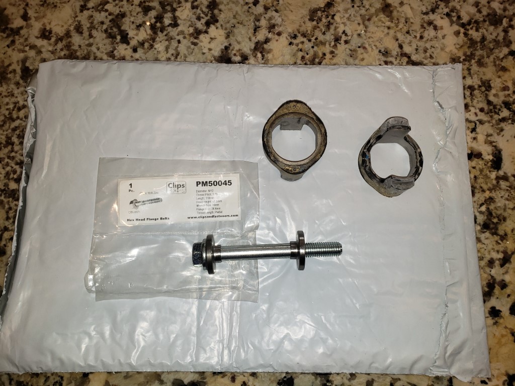

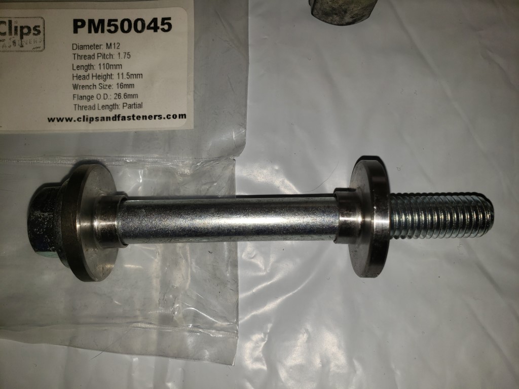

Checking things out before the new sphericals get here:
Here is the bolt and sleeves:
10.9 bolt 110 mm long (stock length). I also have 2 @ 130mm just in case. These look like they'll do very well!
Also:

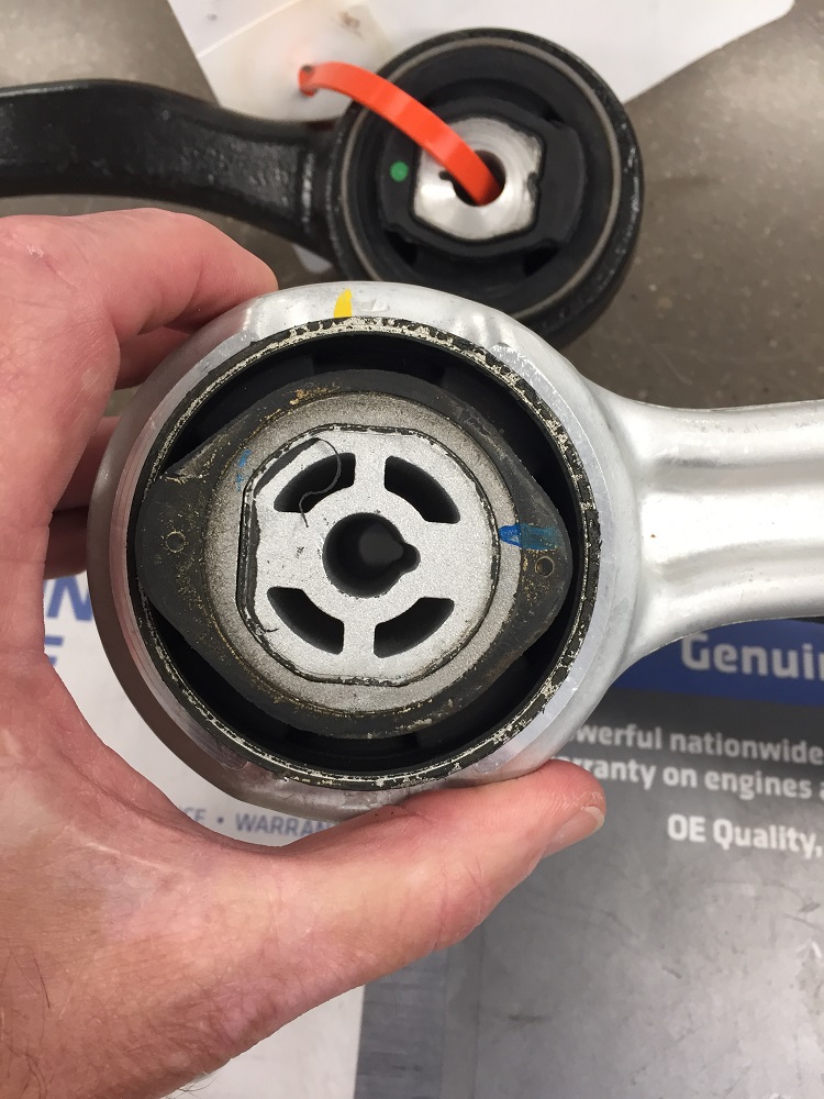

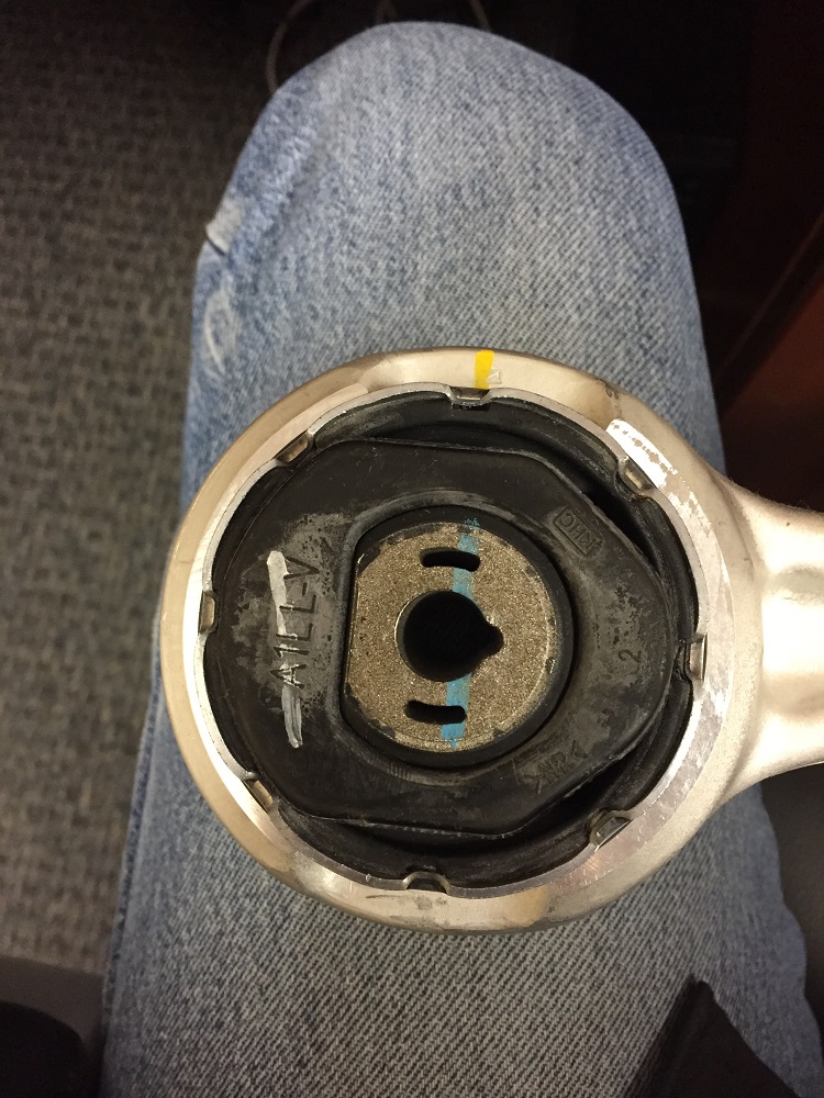

Wanted to show the Radius Arm bushing insert -- these are a combo of JSPP insert and very 'hard' rubber:
These are kinda similar inserts as the 1LE (1LEs are D shaped however) -- I think if I were to do this again, I'd just get the 1LE arms (the voids are filled in more in the aluminum bushing) and forego the spherical insert -- these look damn tough!
Have to give it to the engineers -- made these things lighter and really looked to make these things ready for the track!

I wonder what the difference is between the SS 1LE radius rod and the ZL1 1LE.
2022 1SS 1LE A10 BCD WCT+PDR2014 1SS 1LE NPP RECARO SIM-SOLD1995 Z28 M6 GSC PGM-SOLD1975 NOVA COUPE 300HP 350 TH350 FLASH RED-SOLD
"KEEP THE FAITH"-Fbodfather
cdb95z28 is offline   Reply With Quote
Old 03-25-2019, 03:53 PM   #2420
hammdo
'It's an experiment'
hammdo's Avatar
Location: Dallas TX
Posts: 8,709
My guess is it’s the same as the SS 1le since they don’t show Different part number. The 1LE version is more stout for sure...

So, as an experiment picked up 1LE radius arms too. Checked the zl1 1le, they listed the same but, that could be just what they say.
I’ll have them Wednesday...
The ones for the zl1 1le look like the 2SS versions but, a different insert. $62 each but, I cant see ‘why’ they would be better.
-Don

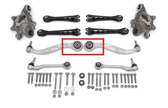

So, this is 1 part of the zl1-1le handling package (minus the DSSV kit):
In the square red box -- those are the ZL1-1LE version.
Those sure look the same as the 2SS:
And not the SS 1LE version (below):
-Don
