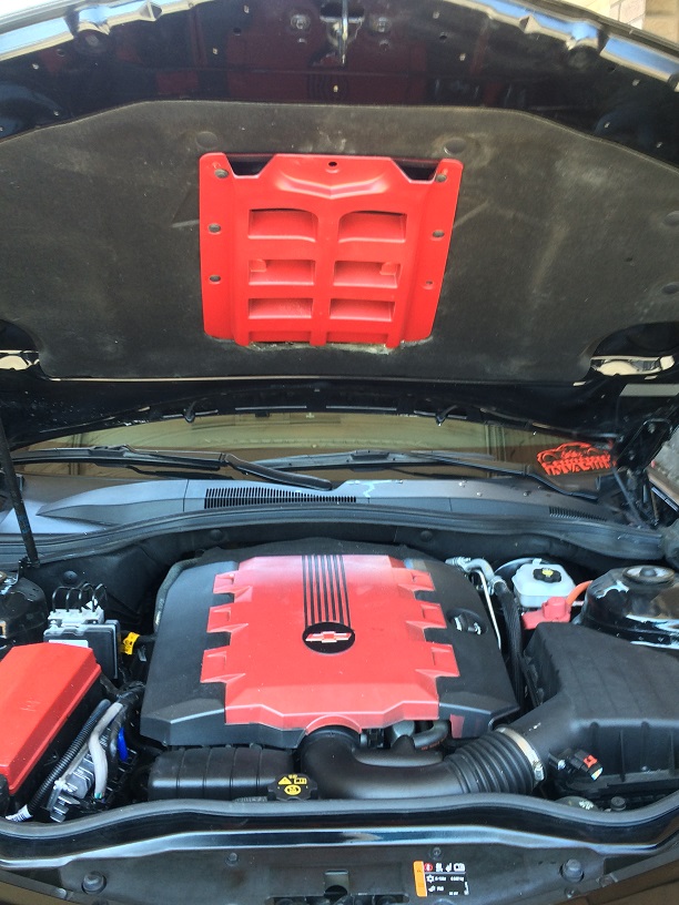

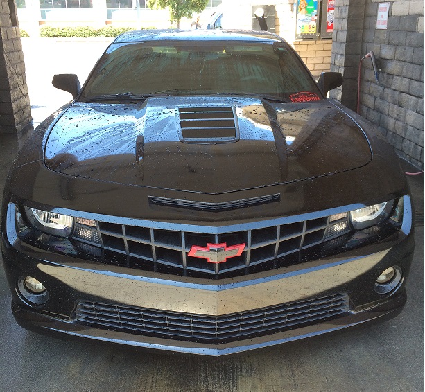

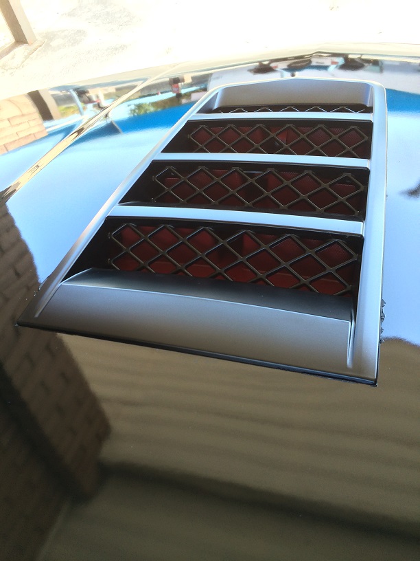

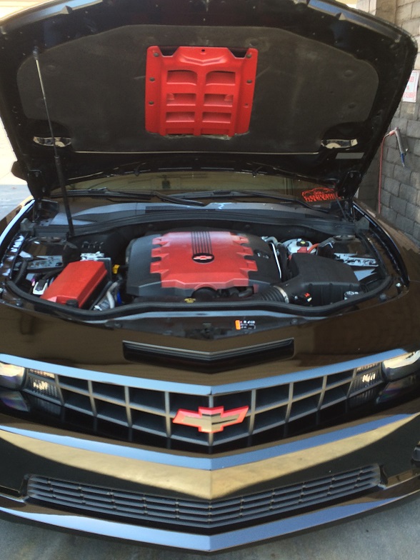

finally got around to snapping some pics of the final product..
Looks ****ing epic, love the car. What's the difficulty on this project?
Thanks! The whole cutting part is obviously the toughest part.. I didn't have the tools to do it myself so I had it done a at a local body shop.
