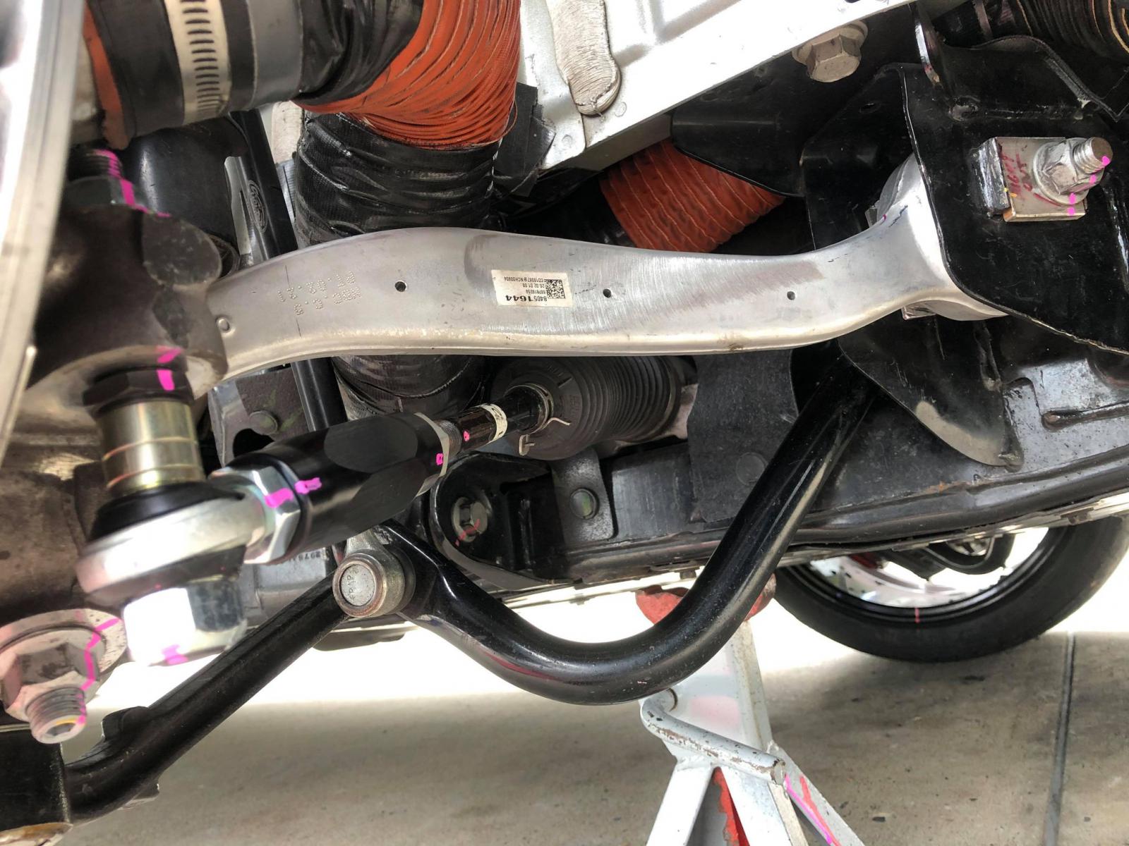

I also installed the Baer Tracker Bump Steer kit. Unfortunately neither Baer or LSR make the correct kit for the 2014/15 Camaro 1LE and Z/28 which have a bigger 16mm tie rod. So I had a machine/fab shop that does work for my employer drill and tap to the correct thread size of 16mm x 1.5mm. I did the kit before I added the ZLE radius rods. My caster before was 7.2* and with the bump steer kit, the steering felt a little like a Gen6 SS 1LE.
But once I added the ZLE radius rods, the bump steer increased and my bump steer kit was already maxed out. It doesn't feel bad, it feels like before I did the bump steer kit.
The advantage of more caster is that caster helps the dynamic camber on both the loaded and unloaded front tires in a turn. For example, in a left turn, the RF tire is the loaded tire. Caster will add negative camber to this tire, which is what we want.
The unloaded tire, the LF, needs negative camber removed, and caster will help the tire go towards positive camber, which is what we want.

Yes, it will pull the wheel/tire assembly towards the front of the wheel opening. I have no rubbing or clearance issues with 305/30-19 3R Goodyears. But, I have not confirmed any clearance issues with the OE 20" wheels/tires or with 325/30-19 fronts.
Here is a pic I just took with the ZLE radius rods at -2.9* camber and +9.0 caster. I lost .2* of caster going from -2.2* camber to -2.9* :
