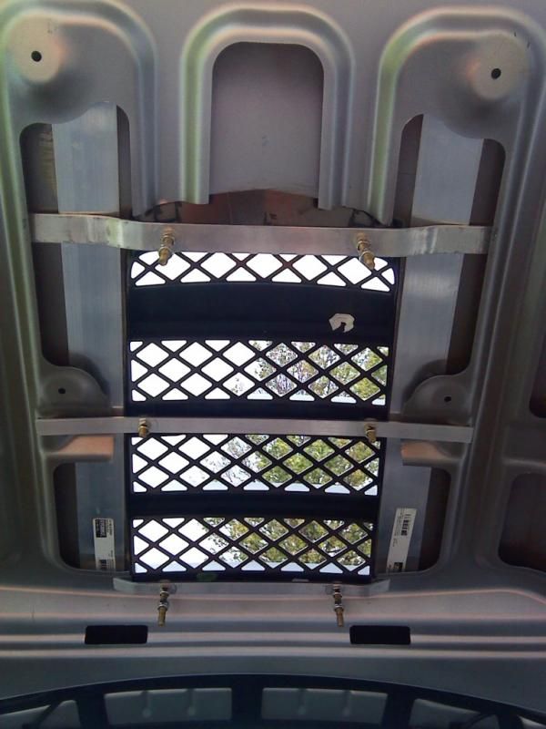

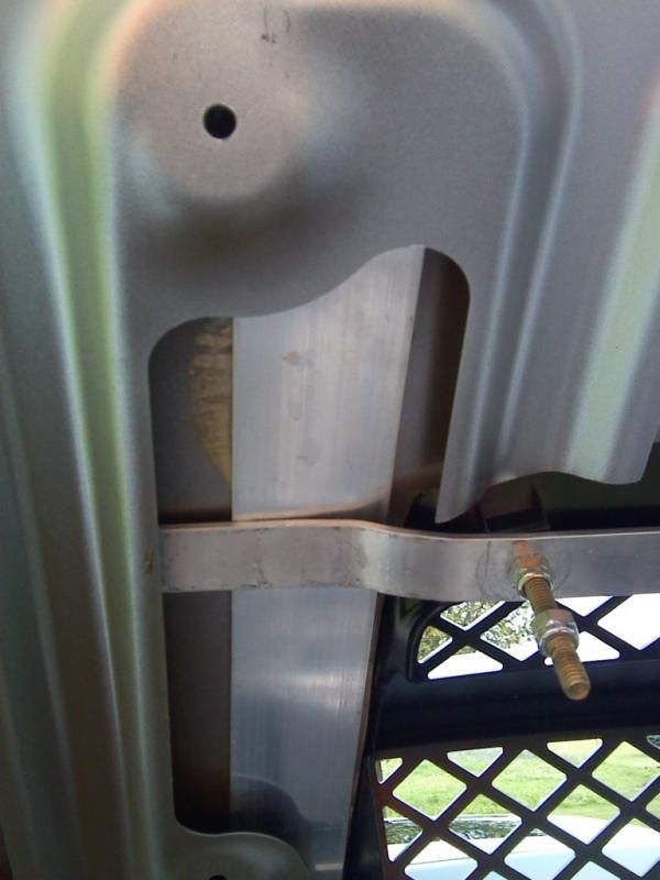

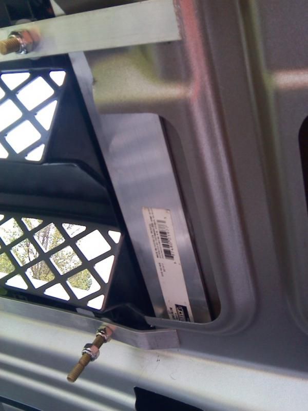

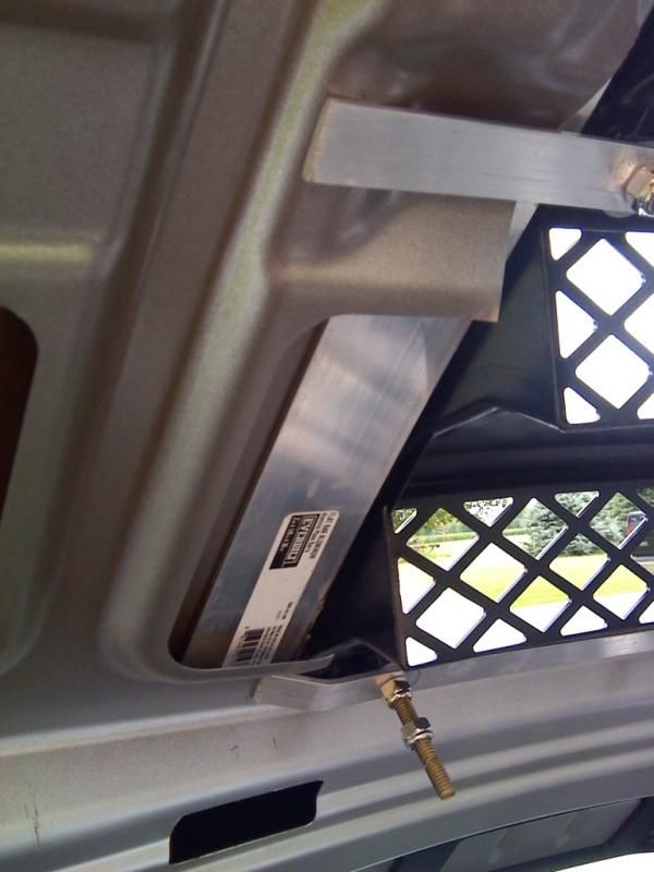

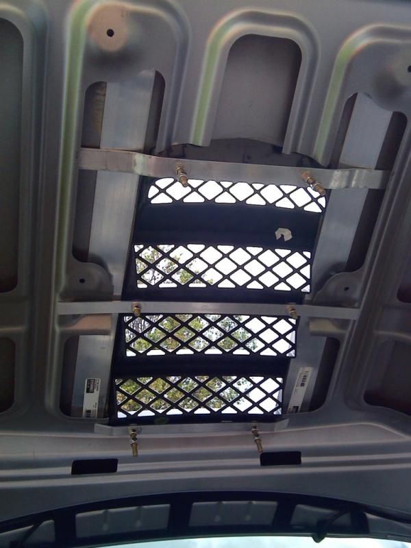

Eddiefuzz Under the hood pics. Looks good IMO.

Thanks Jerry!These Pics show the 2 inch X 1/8 aluminum strips that I put on each side of the Extractor. I found that the edges of the hood near the Extractor were VERY soft, I added these to stiffen and support the hood. Please remember I placed my Extractor as far back as I could, MINE IS NOT In The OEM location. The length of the aluminum strips will vary, mine are also "TUCKED" under the support metal. I also put a slight BOW in the strips before I added metal epoxy and slid them into place. Now if you press on the hood at the edge of the Extractor it is very firm. The strips come in 24 and 36 inch lengths, I needed 30 inches, your will differ. Everyone loves my car with this mod. Good luck with yours.
