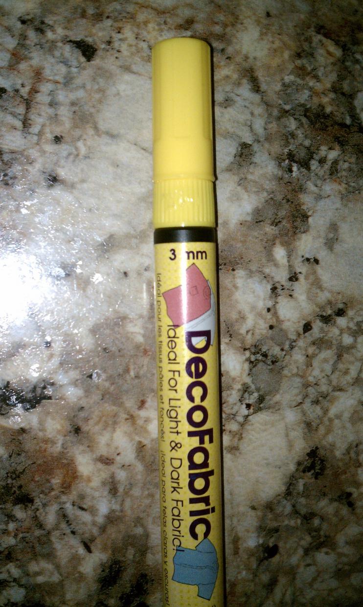

here is a picture of the fabric pen i used for mine.

Thanks for the info on the pen. That looks really good. Has it rubbed off on your clothes? Any fading? Any bleeding onto your leather? Sorry for the tons of questions but you are the official expert.

no problem about the info at all. no there is no rubbing off on your clothes at all, so far there is no fading at all, i have had it for over a month as a daily driver and a friend had his done for over 6 months and still looks as good as new. as long as you take your time and wipe the stiching line after every foot or so it comes right off the leather without and sign of bleeding at all.( do not do the whole car and allow it to dry before running a damp rag over it. if so it can dry and then stain the leather). if you wanna see closer pics or have any other questions just ask. by the way i would suggest 4 pens to do your whole interior.

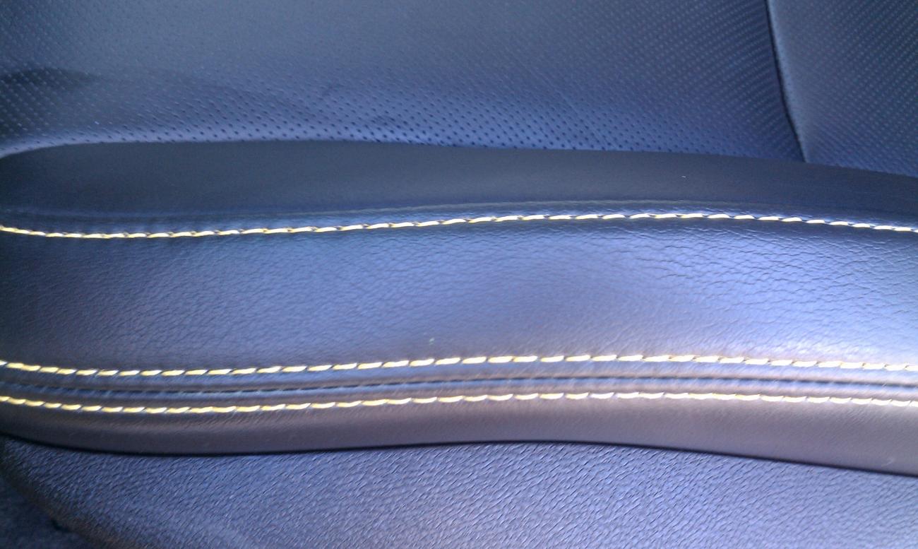

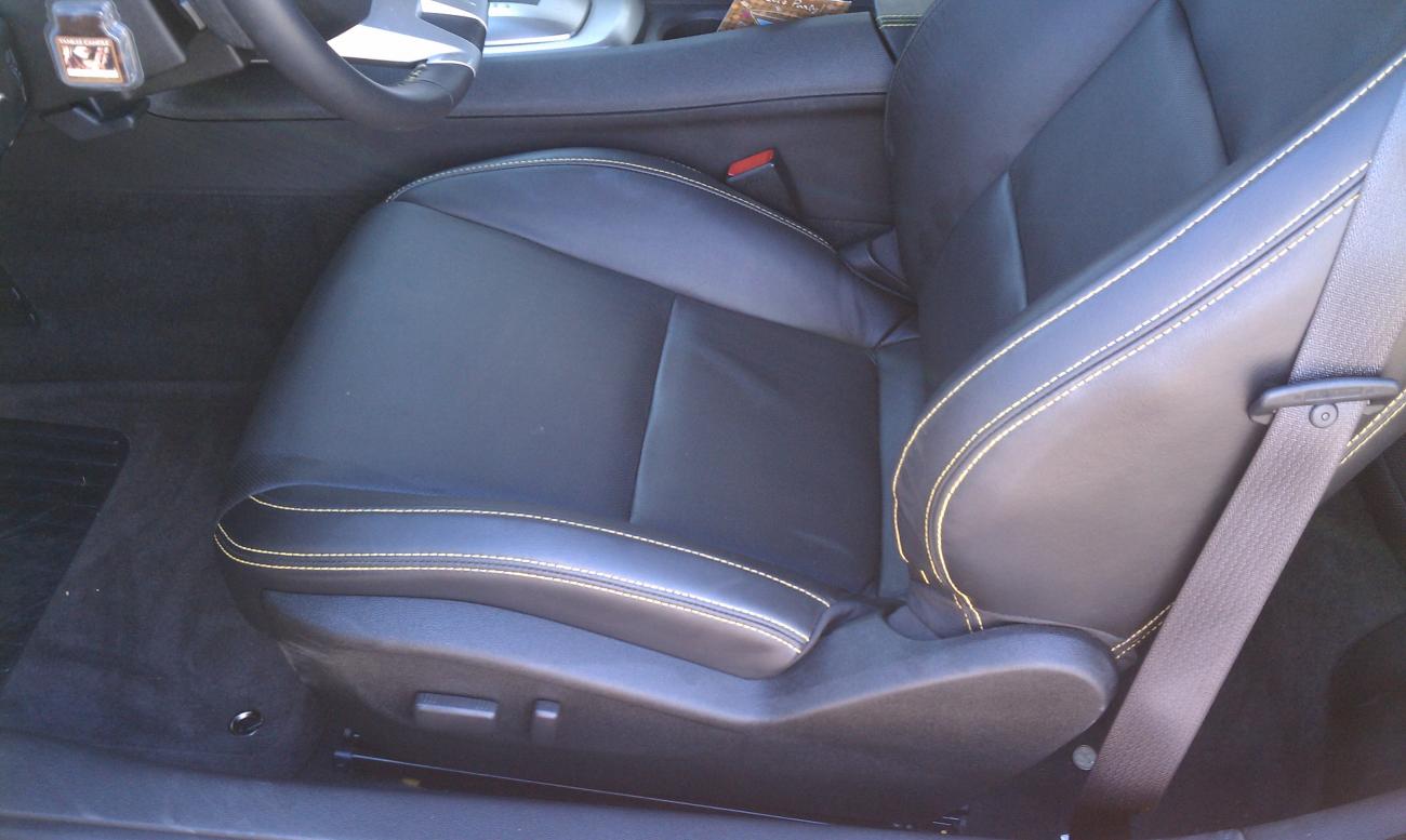

I just did mine with Dye pen and it turned out Great. I did everything with 1 pen. How did you need 4? Thanks for the info.

it looks great garysss. no idea why it took 3 pens to do mine. maybe there was still dye left in mine when i tossed them. it starting coming out lighter so i tossed it and grabbed a new one. maybe i just needed to shake it up some more. but at 2 dollars a pen i wasnt to concerned. its a great very inexpensive mod. i keep one in the glove compartment in case i ever need it
