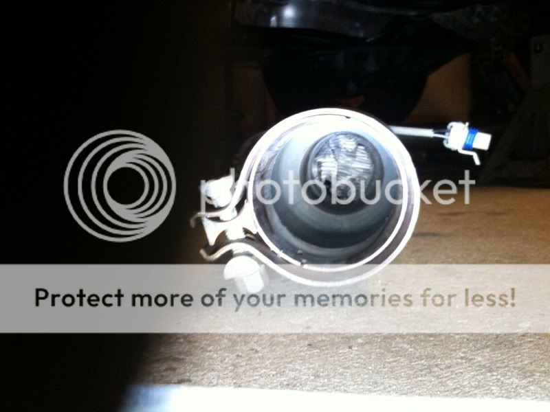

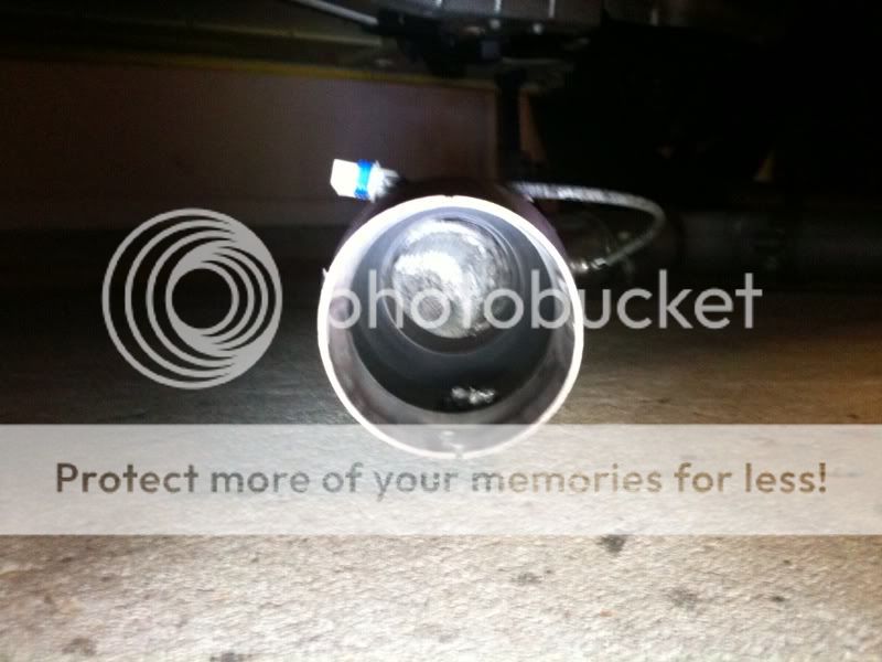

Here are a few pics of how it looks when they come apart. Notice these are in the pipe behind the cat, as the cats were totally burned out and hollow. No need to order another its now a self made off road x pipe with the cats in place!

Even these High flow Cats were never designed to handle the Power we are making with these engines.
Cat converters are built with Cubic inch and HP in mind, when you add a Blower your basically Doubling the Cubic inch displacement.
The Cats would need to be Triple the size to handle the HP we make.
Disclaimer, These mods are for Off Road Use ONLY.
Ted.
