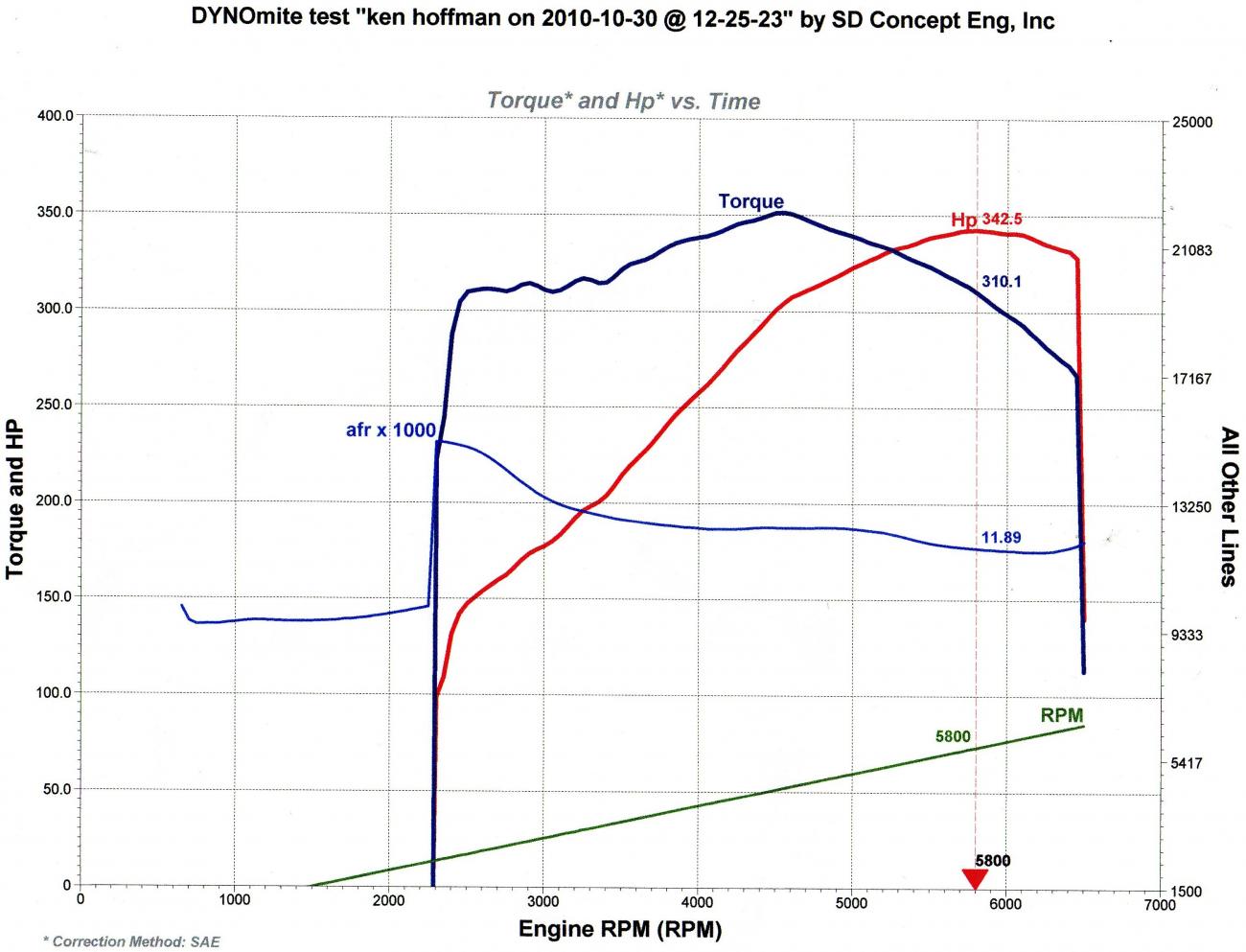

Kens Dyno Graph
Here is a scan of my dyno graph guys, I would like to see other stock ish SS for comparison, seems like a lot of variation car to car......
You can really see the torque managment below 3k rpms.....yes even the manuals have torque management built into the ECM......well until I get in there and fix it
Ken
#6 Bolt on Fast List...best ET 12.01@117 mph
http://www.streetfire.net/video/best...ro_2240734.htm
hoffmk2003 is offline   Reply With Quote

Wow is that a stock tune..... I thought the L99s had a lot of torqe management below 3k rpms.....yours looks almost exactly like mine.....just slightly less power. Hmmmm

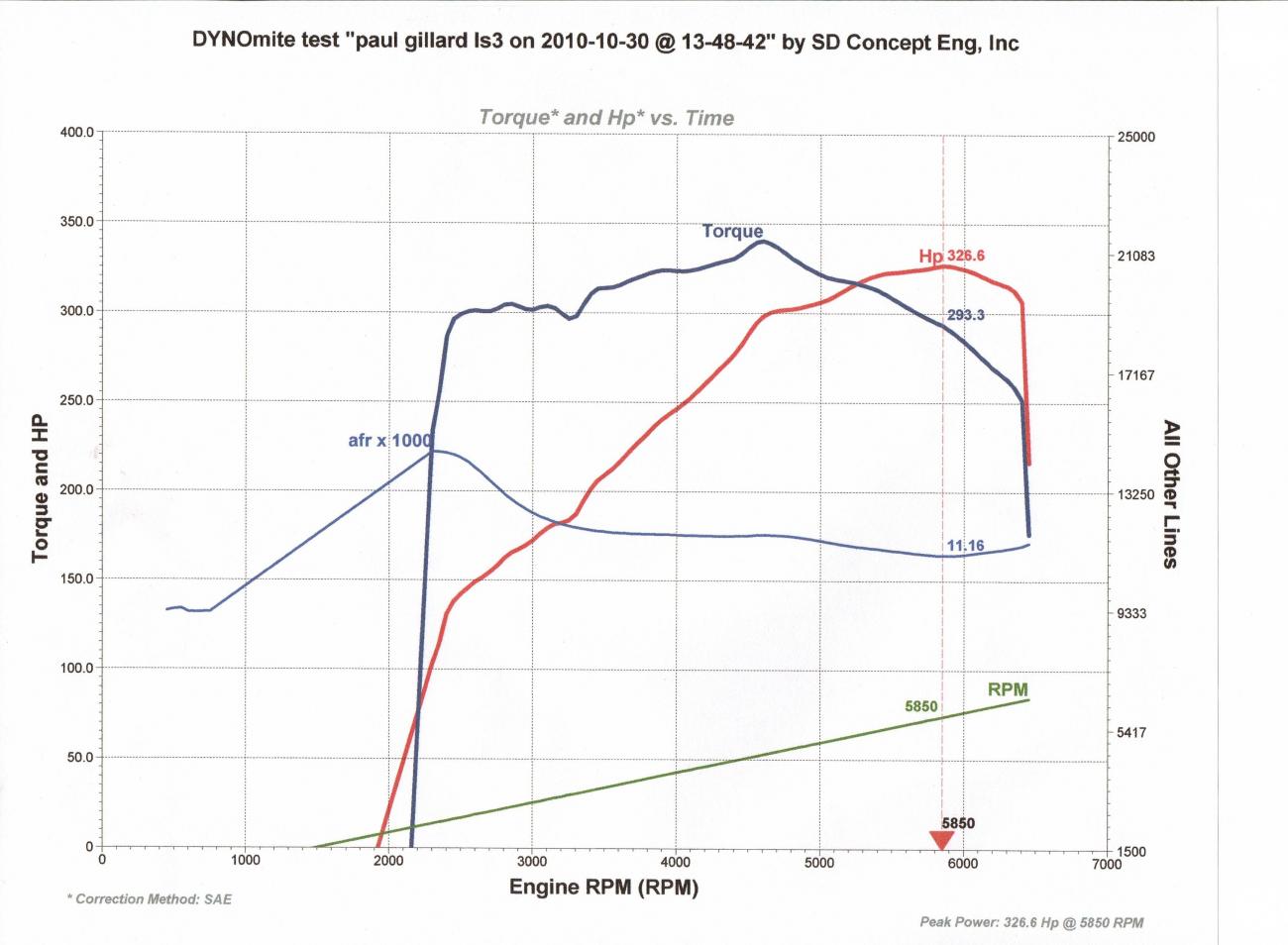

Here is my dyno graph for comparison. LS3, only mod is a New Era intake tube.
Notice how rich it is at idle compared to the others, what's up with that?

They pretty much all seem to be rich on idle and lean out to around 11.5 or so. Even on my graph.

GMs typically idle rich. also remember we are measuring the AFR after the cats at the tailpipe, which is not the best way. Best way is right off the manifolds for most accurate fuel readings.
I am curious to see what it will read with my wideband before the cats.... I'll find out next spring I guess.....
