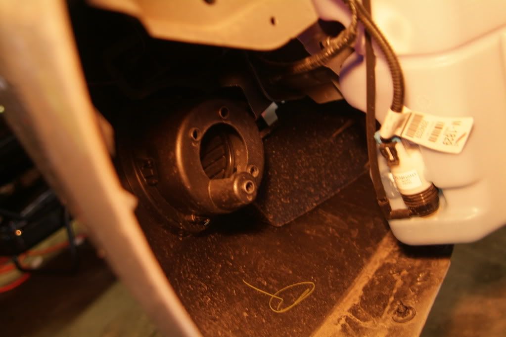

Originally Posted by DeputyBreaux View Post
my dealer said the same thing..i want to install fog lights but have no clue how and everyone i ask seems to not know eithor..you know one dealer even told me to trade my ls in for one with fog light ..smh..what was the total cost?
I think the total cost ran about $200.00 for bezels, harness and fog light assembly. REMEMBER, if you wire 'em to the side marker lights, they only come on at night or when you turn on the parking lights. You could add a switch and relay if you wanted, but that's way more involved...

Originally Posted by meschwenk View Post
I was thinking of doing the same thing to my LS, but I'm new at this kind of stuff. Sorry for the dumb questions.
I have not seen the wiring harness from GM, so is it just two wires with plugs on both ends and you just cut off the one plug and splice that into the side marker lights?
Did you have to order two harness?
Are the Hot and Ground wires different colors on the side marker lights?
Thanks!
Right, for the harness, there's a separate socket that you won't need. Just get some connectors from Autozone or Home Depot. Solder those to your leads and connect them. That way if you need to disconnect, you won't have to cut and splice...
order just ONE Harness, that's all you need. I can't remember if the wire colors are different, I think the ground leads on both are black though. I remember it was obvious though....

Ummm....you took off the front. But it can be done without removing the front end.
