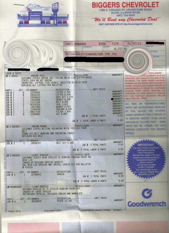

Originally Posted by blackknight View Post
Got my ride back tonight. For the spoiler paint chip they repainted the whole decklid and installed the new grommits to keep it from rubbing.
My AC belt was was squeaking bad so they replaced that as well.
As for the lifters they replaced all the lifters. This meant taking apart the engine all the way to the block. So now the engine has all new gaskets and seals etc. Also got a free oil change out of it too lol.
Car ran fine on the way home, i really didnt test it out, because it was snowing and i had ZERO traction with those pirellis. kept fish tailing doing about 25 mph.
But im gonna start it up later after its been sitting and see if the ticking is truely gone.
Hey Blacknight can you look at the worksheet and give us the part number of the replacement lifters they used. Thanks

Here is the paperwork from the dealer.
They would tick after it would sit for a while on startup. There was a TSB on it. GM picked up the bill on that one.
and yea the guy was working on it, he just stepped away for a minute.
Mine still ticked after tuning out the AFM. the lifters just have a defect. the new ones fix it i guess....
You're tuned and GM picked up the tab on the lifters?

Old 01-08-2011, 08:53 PM   #20
blackknight
Camaro Lover
Drives: 2014 GMC Sierra 5.3L
Location: Chicago 'Burbs
Posts: 709
there was a TSB.....

Old 01-08-2011, 09:04 PM   #22
blackknight
Camaro Lover
Posts: 709
I just started the car a while ago after it has been sitting in the garage since yesterday when i brought it home. started up....NO TICK! hurray!

Originally Posted by TripleB View Post
i'm gonna be going in for my 5,000 mile service next week or the week after. i've noticed mine ticking a little too. i thought that was normal. i'll have to have them take a look at it. didn't know about the TSB.
use the bulletin number from my scan in post #18.
