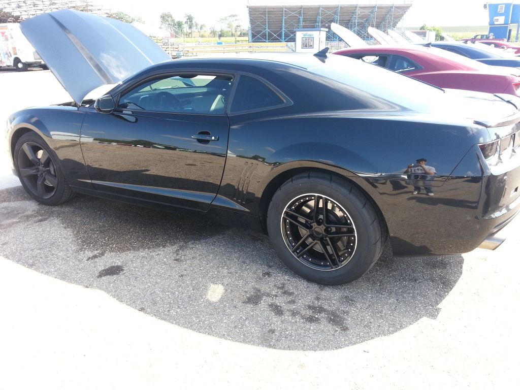

so after being able to finally make it to the track several times this year, i have been able to identify a big power killer when it comes to me making multiple passes.
HOT Intake Air Temps.
usually after my second pass i am noticing that my IAT are reaching well over 200 degrees. and for those that arent aware, our computers will start pulling timing as soon as it sees temperatures over 130 degrees. And when timing gets pulled you lose power. I was noticing this in the top of 3rd and all of 4th gear because i basically was losing power
one of the main reasons is i get impatient in between runs so i like to try and get as many passes in a day that i can. So we looked into alternative ways to help cool my temperatures down while running.
yes i can come up with the money to install an intercooler but that would cost a lot of money and take a bunch of time for new fabrication. Plus that still will only cool it between 10-20 degrees roughly. Which isnt bad, but not good enough.
so after a little bit of tweaking and researching i decided to add these mods to my list.
*2000 threaded IAT sensor off a 2000 corvette(gm part number- 25036751)
*pigtail wiring harness (gm part number- 12102620)
*AEM water/meth injection kit
Now i will start explaining the whys behind everything here.
to start i will show a picture of my current chargepipe coming into the throttle body. the current location of my MAF (which also reads our IAT's) is low down behind the radiator on the passenger side. It is a known issue that our MAF's are prone to heat soak. I realized that at idle and normal cruising temperatures, my IAT were displaying on average 110 degrees. No matter what the ambient temperature was. it could 80 degrees outside, or 40 degrees and my idle temps were about 110. That is a perfect sign of heat soak. So we decided not only will adding a separate sensor help with more accurent readings it will allow for my computer to properly take advantage of the cooler temperatures provided by the AEM kit. so here is a shot of the charge pipe before install. you can see the location of the MAF.
and here is the picture of the new IAT sensor and harness i ordered
you can see the actual plastic housing around the IAT allows for much better air flow so it will be able to avoid head soak better and more accurately read IAT's
this is a quick shot of the controller for the water/meth injection
Now just to disclose i decided to go with the threaded IAT sensor because i am running boost. If you want to do this setup and you are supercharged or N/A, you can order the IAT off of an ls1 camaro 98-02 and a rubber grommet (IAT sensor 12160244 & rubber grommet: 24504388). This will allow you to insert the IAT right before the throttle body to give you a much more accurate reading.
so far with my the new location of my IAT. i am seeing idle temps between 10-15 degrees above ambient temperature, and cruising speeds around 15-20 above ambient. that is a huge difference just there alone. also i notice that after doing some pulls with the car it drops back down to these types of temperatures a lot quicker as well.
so not only did install this but like i mentioned above i put in the meth injection. It states to take advantage of the meth as much as possible to install it roughly 6-10 inches away from the throttle body. So we installed in a way that is sprays directly into the throttle body to make sure it sprays evenly. you can see it in the two shots here
if you look down under the radiator cap you can see the nozzle for the meth/water injection, and closer to the throttle body is the new IAT sensor.
i have not been able to make it to the track yet, but i have been beating the snot out of my car the past few days.
i was driving my car the same way i was before to mimic situation when i would see my extremely high IAT's.
an example would be back to back pulls in 3rd to 4th gear. Let me tell you i have never had a hard time trying to bring my IAT's up. It was a night and day difference. i finally got it where just before i started a pull my cruisin temp was right around 100 degrees after 3 consecutive pulls. As soon as my water/meth kicked in my IAT's did not change. The highest i was able to get it to read was 110 degrees and that was with me beating the living poop out of it for about 30 minutes straight. I was amazed. and now my car feels like its pulling just as hard as it does in 2nd gear, in both 3rd and 4th.
what i didnt get a picture of is where my reservoir is. :-) all we did was drill a hole in the bottom of my windshield washer fluid and ran it to my new pump. Yup, i am basically spraying windshield washer fluid into my car to get these results. Very basic, blue windshield washer fluid is a mixture of about 30-35% methanol and 65-70% water. that is what i am spraying into my engine. Sounds scary right. but it is save and people have been doing it for years.
so i thought i would just post up the initial install. i intend on going to the race tack next sunday to test it all out under those conditions. I am hoping that this will allow me to maintain more consistent times when running instead of suffering from timing being pulled due to the crazy high temps i was seeing.
stay tuned for more results.
