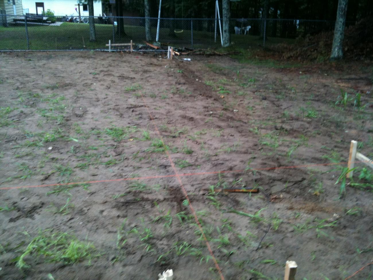

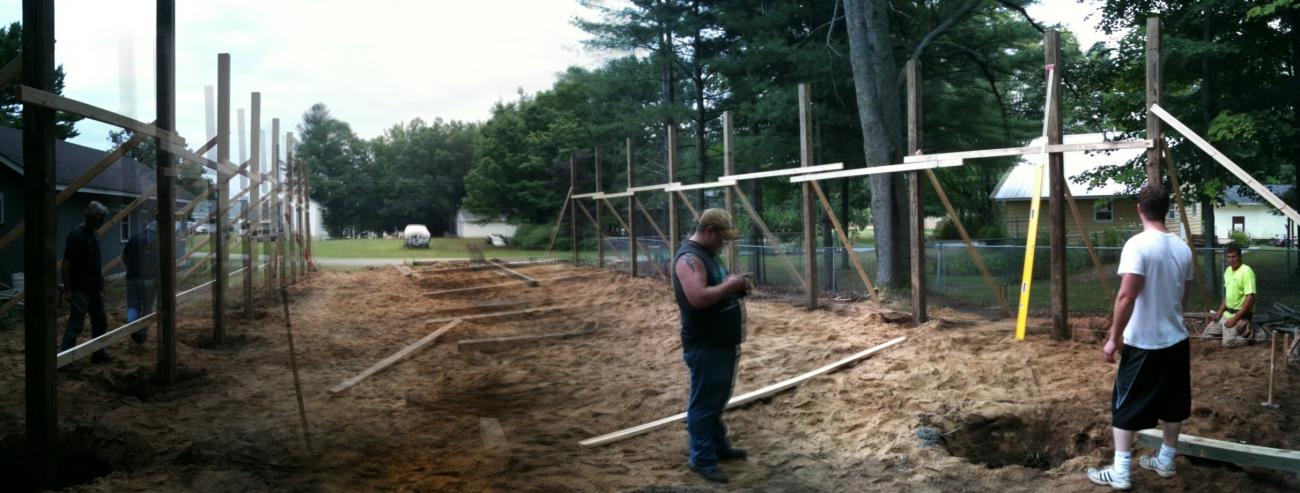

Since we finally were able to get our permit I spoke with my cousin Tyler, the expert that is helping me build this bad boy (man has he). He and his dad have a large construction operation and offered to help me out as much as he could. We decided this weekend was going to be the weekend to get started.
Friday 19th, ProBuild delivered the first part of the lumber package and Tyler came up with some of his equipment.
Saturday 20th, drilled 22 holes for the 6x6in 16ft poles, Grand Traverse County redefines the word overkill... in our opinion at least. haha. Our 22 holes each were 36 inches wide, 58 inches deep, with 10 inches thick of concrete. Luckily I was able to rent an auger, and Tyler brought his Bobcat.
that morning we started by putting up our string and batter board, I believe that is what it is called, it kept our holes and pole placement straight

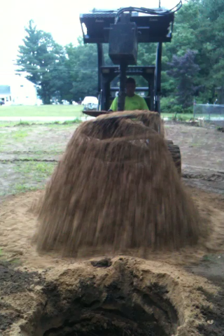

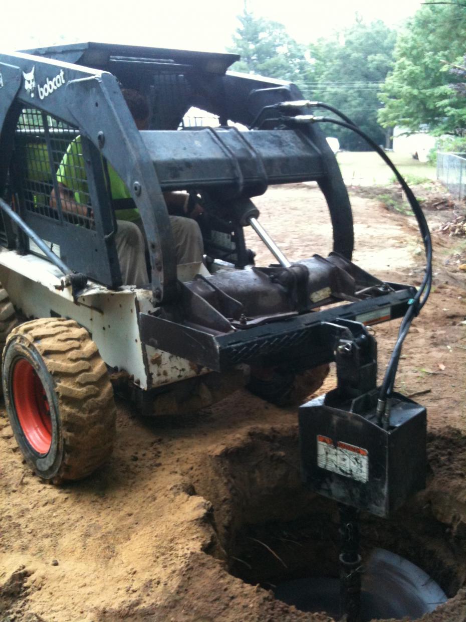

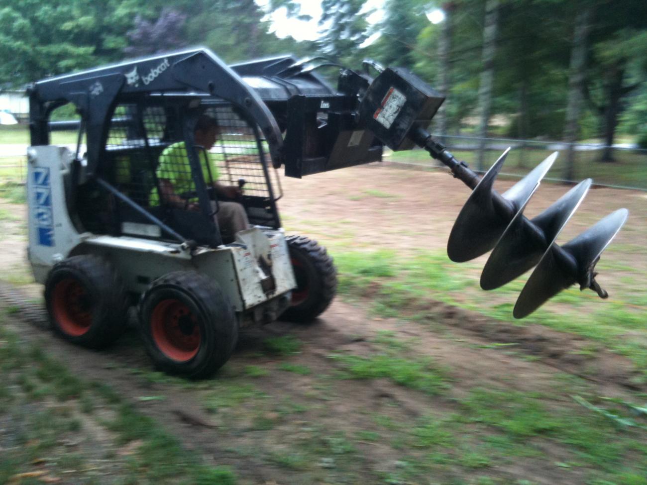

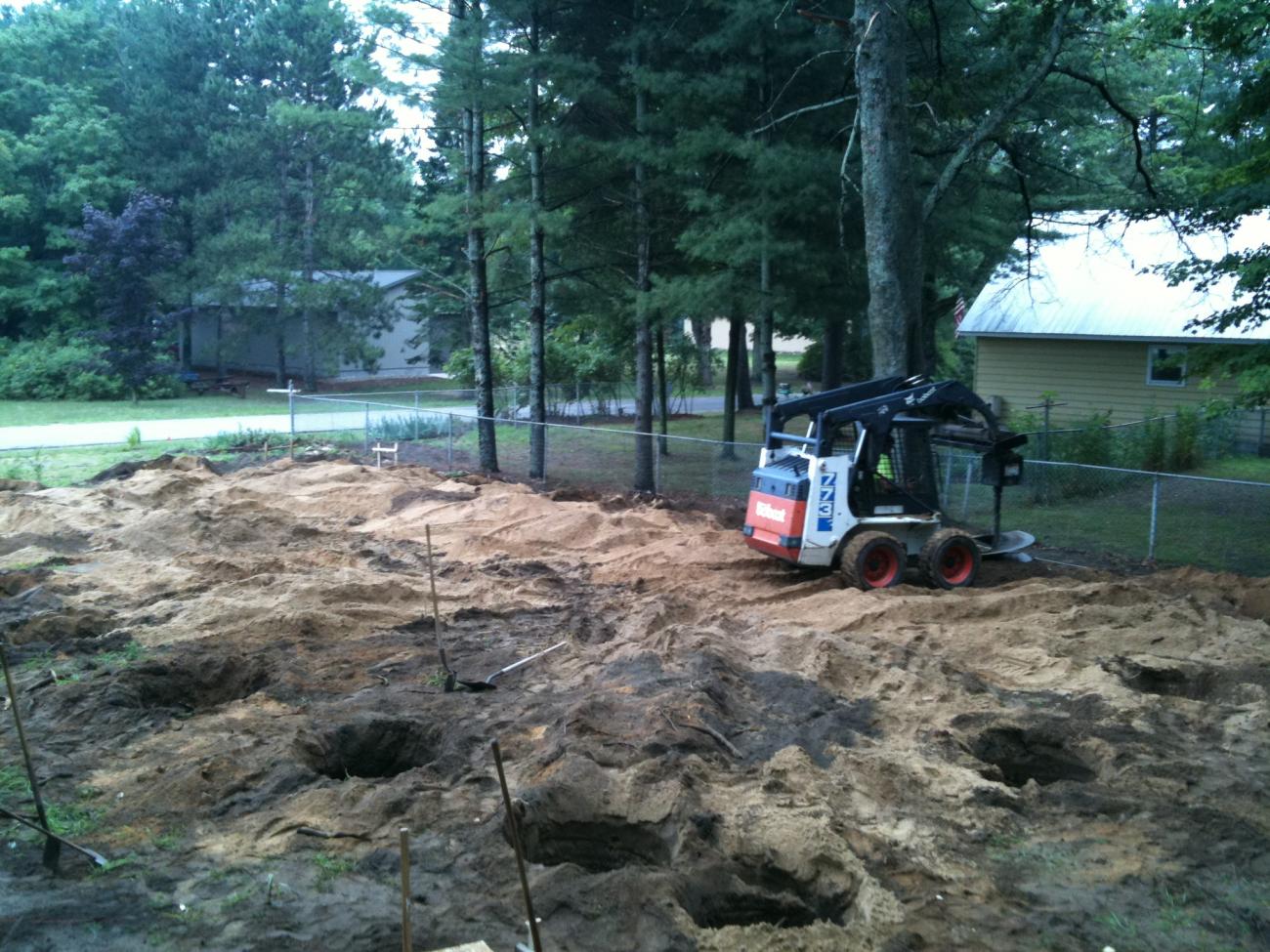

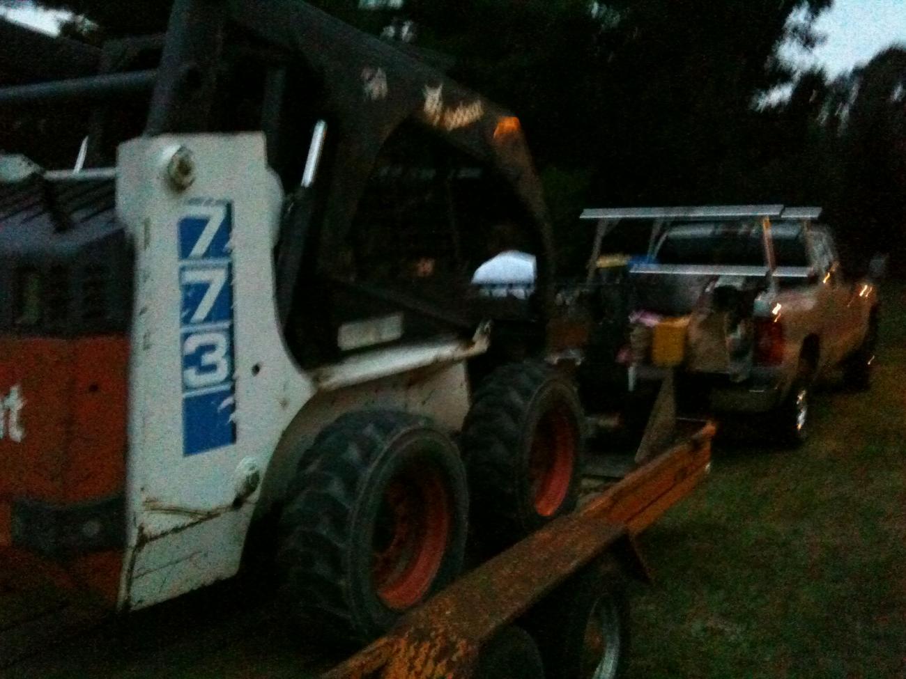

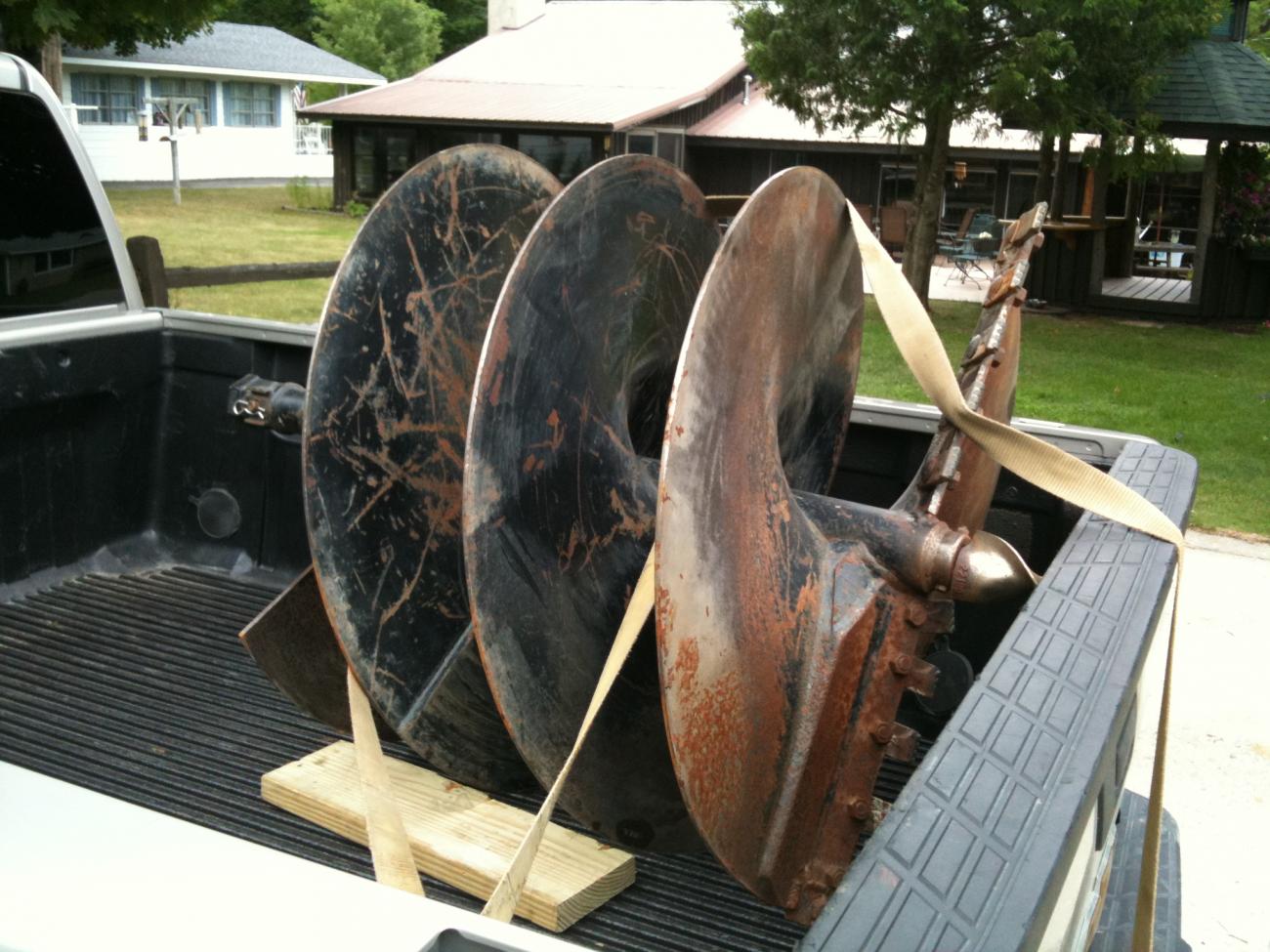

at 7am we started up the Bobcat, unloaded it.. had to get 22 holes dug by noon, as that was the latest concrete delivery we could get. No sweat right!
well, we got the bobcat into place, started to drill.. down 4 inches into the first hole and bam. Auger stops cold and will not start back up.
I was crushed... 15 minutes of messing with it, I knew we would not be ready for concrete. You cannot dig these massive holes by hand.
Tyler had a new auxilery switch installed a week earlier, turns out when I got that torn apart, it only had a loose connection. 30 minutes burned, but we were back to pluggin away on holes.

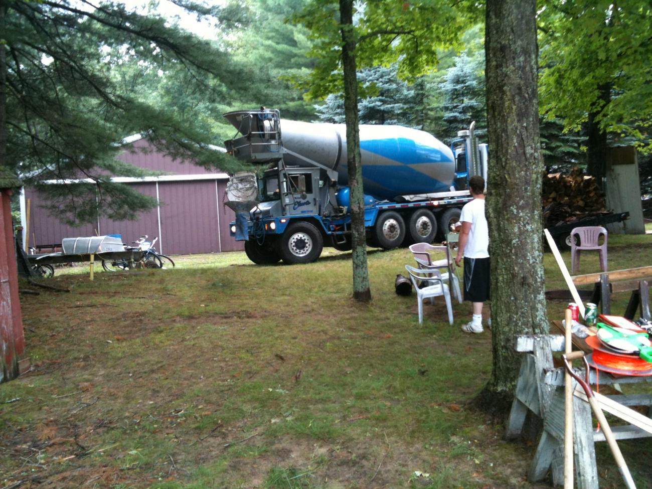

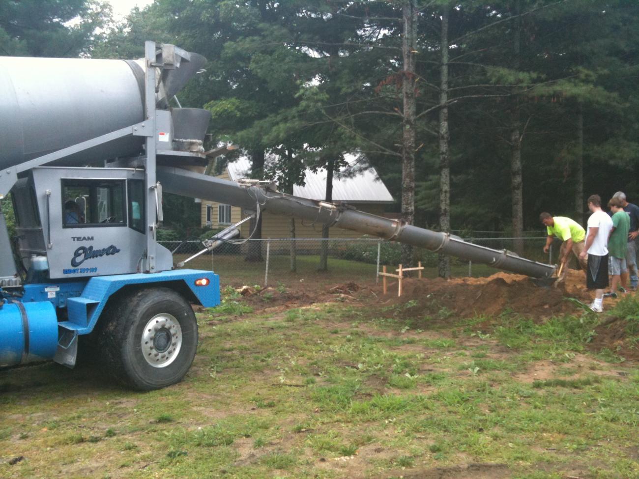

As I metioned, the delivery guy was awesome and since we were about 20 minutes behind, he helped us set everything up for the pours.

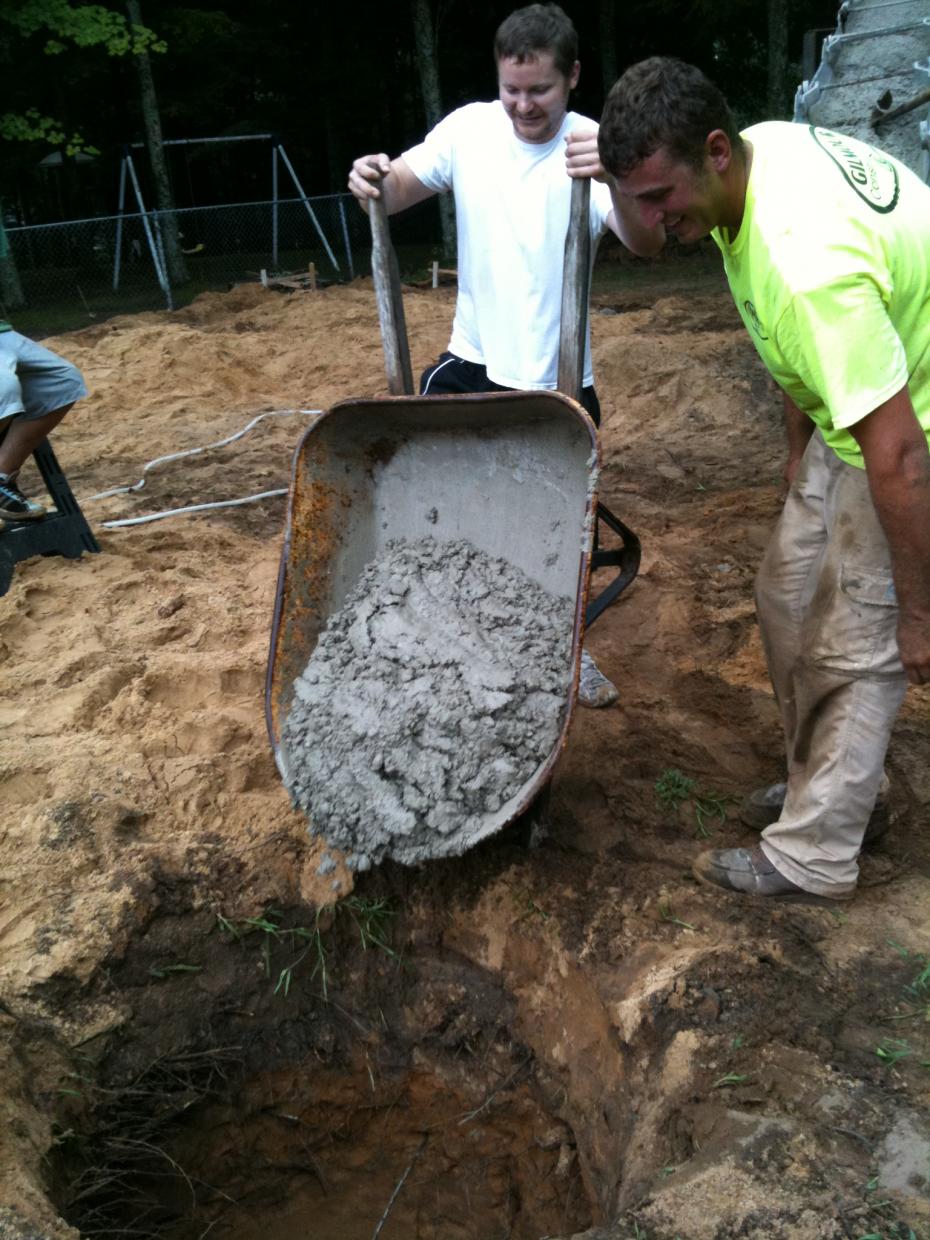

These 22 holes were 36 inches wide, 58 inches deep and we put between 10-12 inches of concrete in to make the pad. about 3-4 hours later we were able to set the poles on them.
to get to the west side of the property was quite tight, but he was a great driver and was able to reach 18 out of 22 holes. We wheel barreled the rest.
I called and asked for an extra half yard, bringing my total to 5.5 cubic yards and we ended up being almost a full hole short. Kind of sucked, but we just sent dad to a couple local hardwares to pick up some bag mix. So it took just about 6 yards to finish to complete

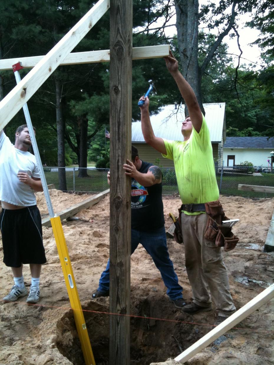

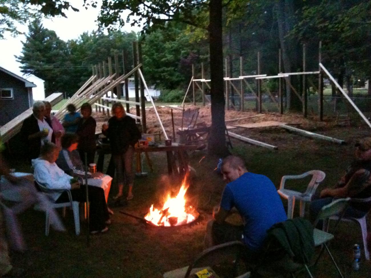

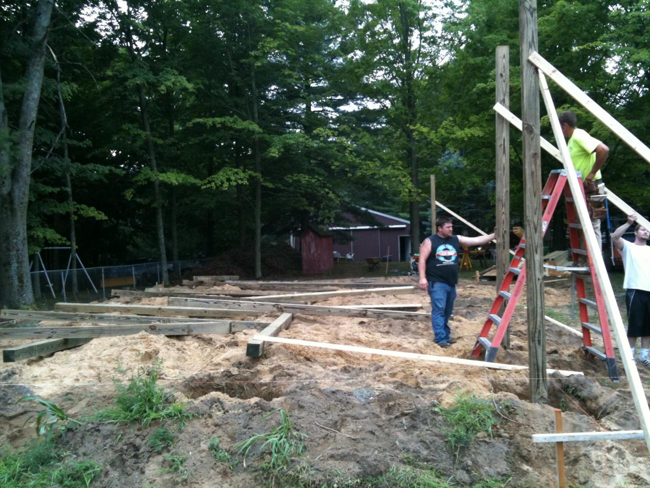

We had a quite a few friends over helping with the poles. I only had to provide the lunch, dinner and after beers... so it worked out pretty well.

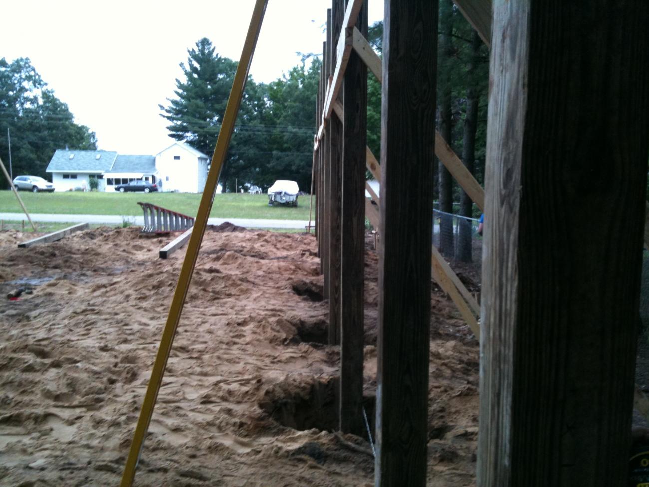

We were not allowed to backfill any of the holes until after the hole inpsection was complete... so we had to brace the poles and put up pearlings to try to keep them all level. It went well, and we even got the laser working finally.

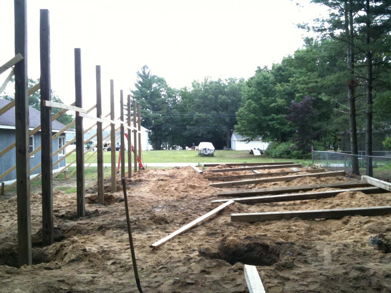

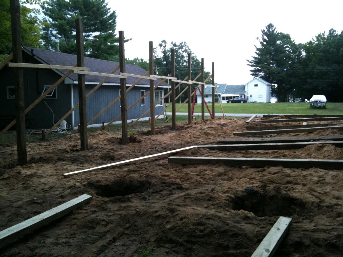

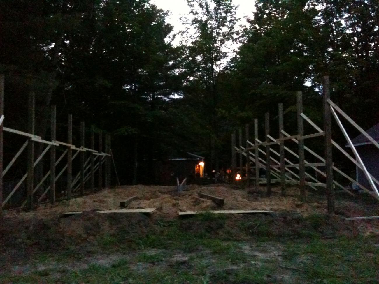

Build day 1 in the books
We were able to get all the holes dug, concrete poured, and poles up and braced... I think it was a pretty successful day.

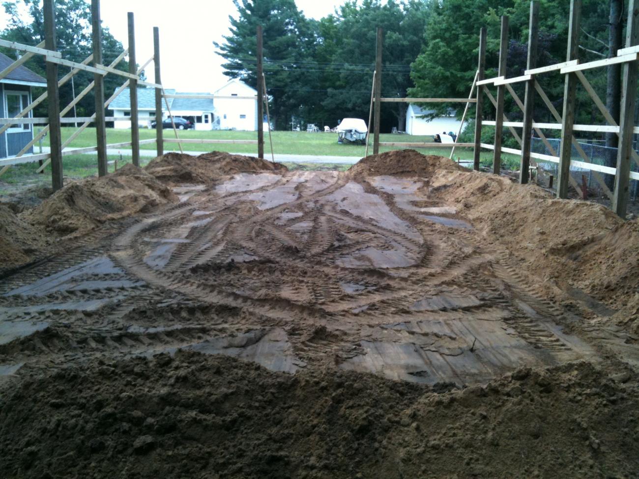

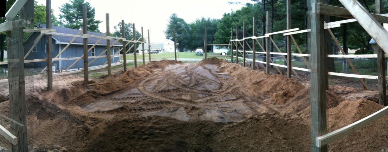

The next day we moved some dirt around to make it easier to backfill when we are finally "allowed" to, and put up a few more peralings.
We then celebrated with Hard Cider, Rasberry Cordial, Beer, and a Bon Fire.
I was pretty dang sore though the rest of the weekend. I am not used to this hard manual labor!
It is now Monday the 15th, I am back in NYC working, Dad will play around on it a bit this week. Then Friday and Saturday I am back at it and we are going to get up the skirting and prep it for the concrete slab.
Tyler suggested we have the slab poured before the trusses and sheeting goes up to make it easier on the masons and will help our when the sky track gets in for trusses.

Ok, Concrete experts, give me your opinions.
30x60, will have either a 4 post or 2 post lift, heated, will house 3-5 cars, tools, and a pool table.
I am thinking since I will never sell this barn, that I should spend the extra money and get 6 inch all the way around. Should not have to worry about cracks at all, and it will let me put my lift anywhere I decide.
This will be about 34-35 cubic yards of concrete at 6 inches,
at $75 a yard is $2550.
This will be about 23-24 cubic yards of concrete at 4 inches,
at $75 a yard is $1725.
I am thinking for the extra 800 bucks I would rather have the peace of mind that this floor will be perfect for a long long time.
I think i have decided that i will def go with the 6 inch floor....

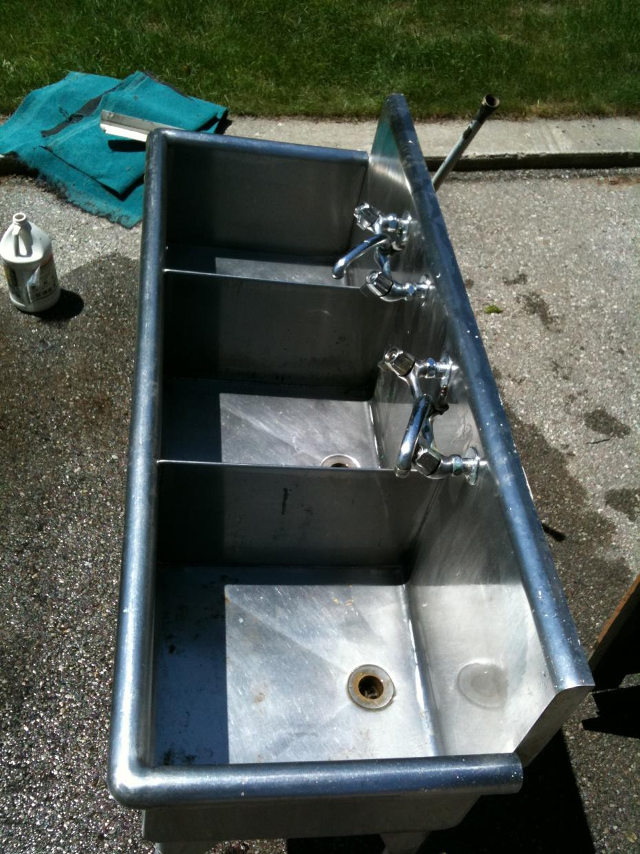

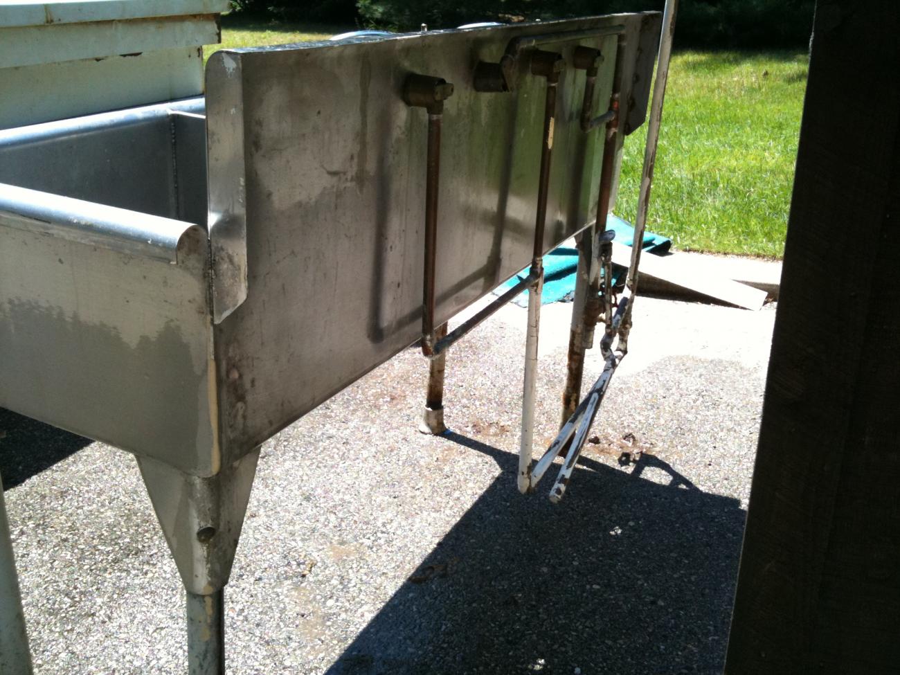

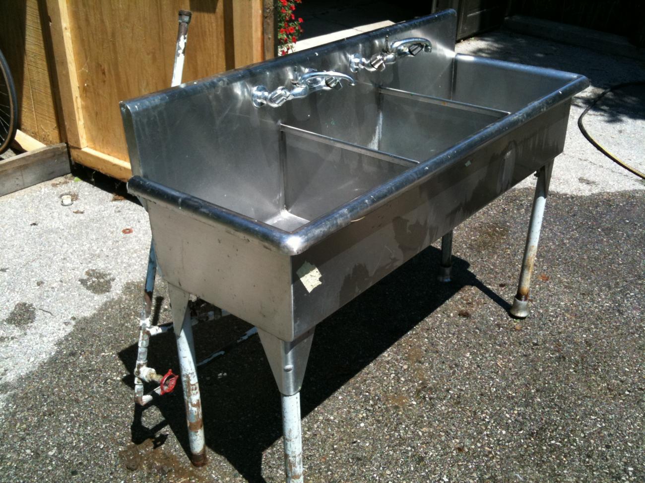

This stainless sink was just chilling out behind the soccer shed, we brought it home and just washed it with soap and it cleaned right up, I will polish it before we install it in the garage. I think I will get a new large faucet for it, maybe one that is Touch Operated so I can use my arm to turn it on when I am too greasy.
