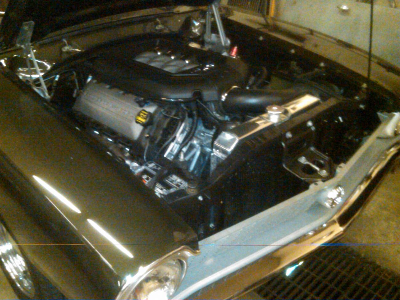

For a bonus I added my buddy's `1970 Maverick with coyote motor.

yes he will be painting it...just enjoying it until the snow flies for now. Boy does at haul Azz!

That's a sick Maverick!
Yes it is !
I never thought I would say I thought there was such a thing as a sick Maverick ! but this my friend is just that.
This thing breaks the tires loose at 80MPH.
I didn't even think there were any Mavericks left...Thought they all desolved. This thing is clean. He bought it for 6 grand with a 351 in it and sold motor and trans.
It has a c4 3 speed auto with 3:25 gears in a 8 inch rear.
Blows peoples minds. Nothing more fun than going to the Ford dealer...or anywhere else for that matter, to get the oil Changed ! The facial expressions when they open the hood are worth a million bucks.
Not a true hard core Ford guy but I can tell you there have been a lot of vettes and Camaros left sitting at the stop light wondering what the heck just happened.
Anyway...not a Ford Thread so I will leave it at that. Just thoght it was worth sharing in case you pull up next to a green 70 Maverick in Illinois at a stop light. Be warned...some things aren't always how they appear.
Good day folks and as soon as I get my motor I will begin the instal details for those who have intrest. Should be fun. Hopefully I will be able to take a Maverick.
