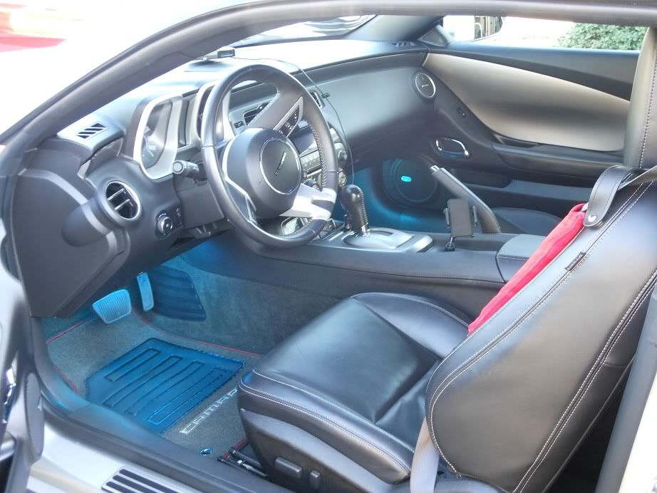

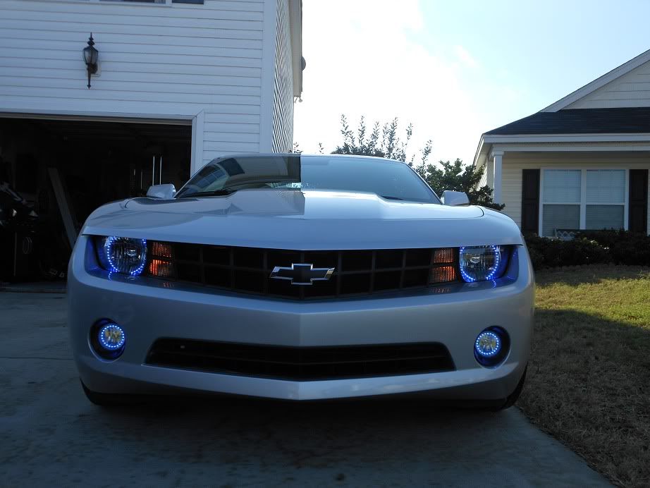

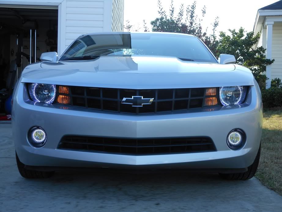

Some buddies in my club helped do mine last June. I also did the fog lights, footwell lights and afterburner lights. We took our time and followed the instructions with no issues. I can switch from White to Blue from in the car and also under the hood.
Here are the lights in white. I get allot of looks and compliments
Here are the lights in blue. I highly recommend gettng the fog lights as well
Footwell lights. I also have the blue dome light and it looks sick at night
