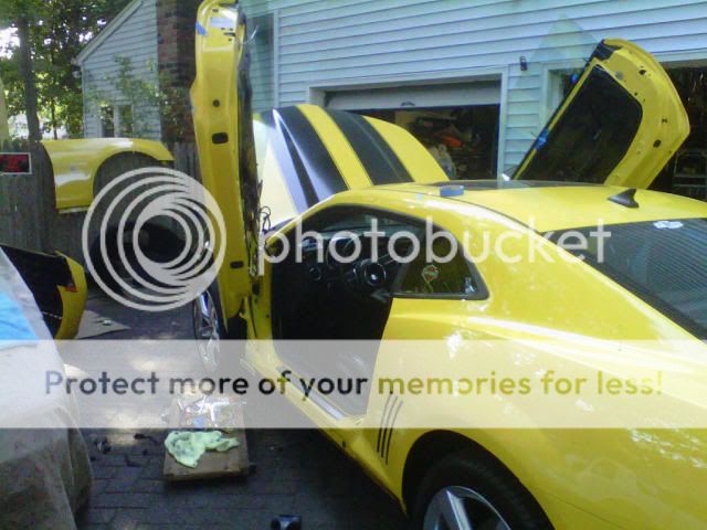

Have had my VDI kit installed since May 2010 and have 50,000 + miles on the car since installed (daily driver- car has 69500 to date).
After I realized the lock nut placement was wrong according to the instructions, I had no more adjustment issues. Doors only go up at car shows otherwise for daily use they open regular. They "do" have a stop toprevent the doors from opening too wide but if someone forces the doors open past that stop there can be some damage.
Installation is a key ingredient to having a trouble free door. If not done properly owners can have problems.
I have installed the doors myself and have also installed at least 4 other VDI kits. Well made product, should have no problems with them but they are not for everyone.
This picture shows the placement of the lock nut The instructions have you placing the lock nut at the "black" arrow side of the bolt. Doing that caused the hinge to drop after a few months and cause a re-adjustment of the door. I placed the lock nut on the other side of the bolt (red arrow) and solved the problem of having the door settle downwards.
For those that are having to readjust the doors try looking at the placement of that lock-nut.
