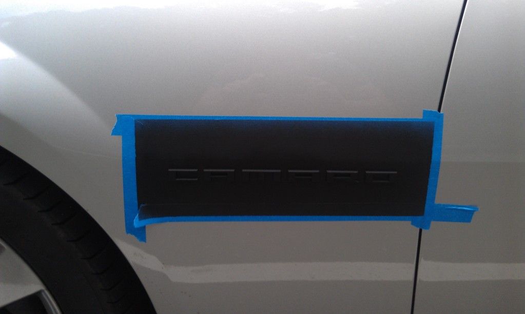

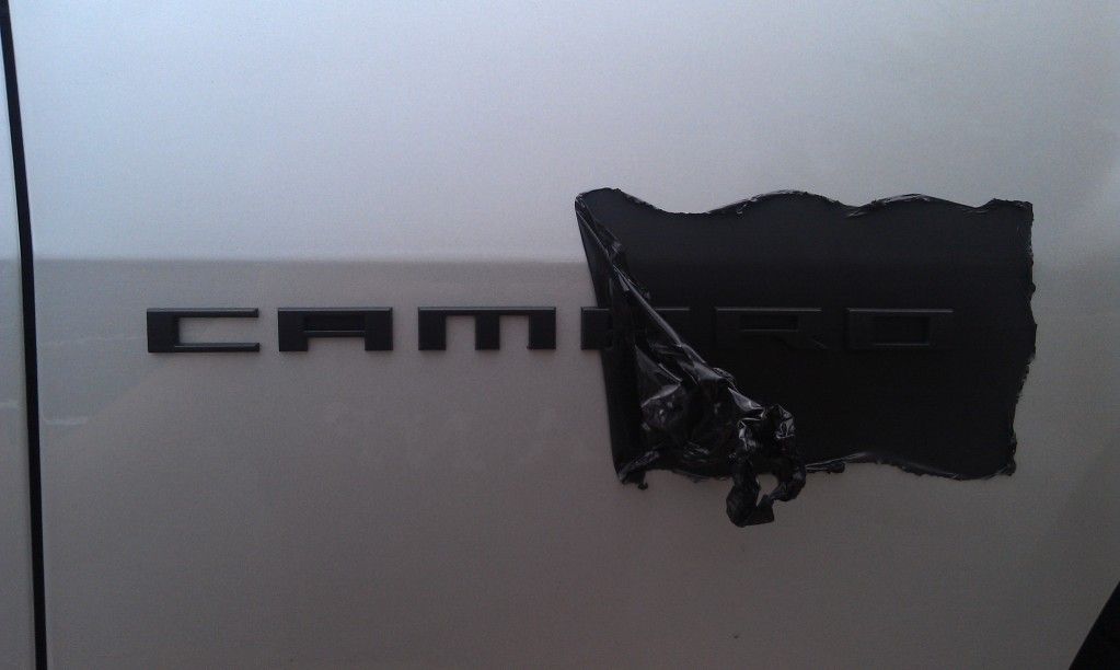

You basically spray everything and peel off the excess around the letters. Using a toothpick or something similar, pick at the plastidip in the letters and take it out like that.

It's a pretty easy mod to do. Just peel slowly and it comes out very clean.

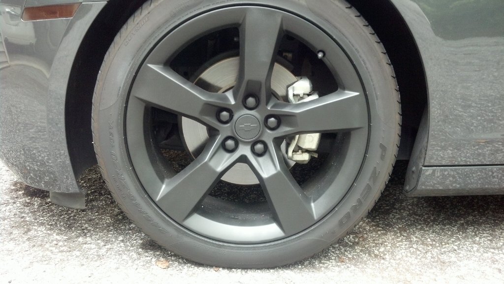

Posts: 145
awesome thanks guys. any tips on plasti dipping the wheels i wanna do it while they are still on so i can get the lug nuts too. another member said to just wrap up the braking parts with trashbags. is it as easy as it sounds?

What is the drying time before peeling?
Originally Posted by mbrusco103 View Post
if you do 3-4 coats of dip, you can just peel it up around the letters and it cuts itself perfectly
I did mine yesterday after about 5 months ago the first try failed because of how cold it was. Me and a friend had some spare time so we pulled my car in the garage and went at it. Did 6 coats all about the same amount. 15 minutes in between time. Notecards between the tires with trash bags on the breaks. Very impressed...$25 instead of $400 or more. I will take it lol
