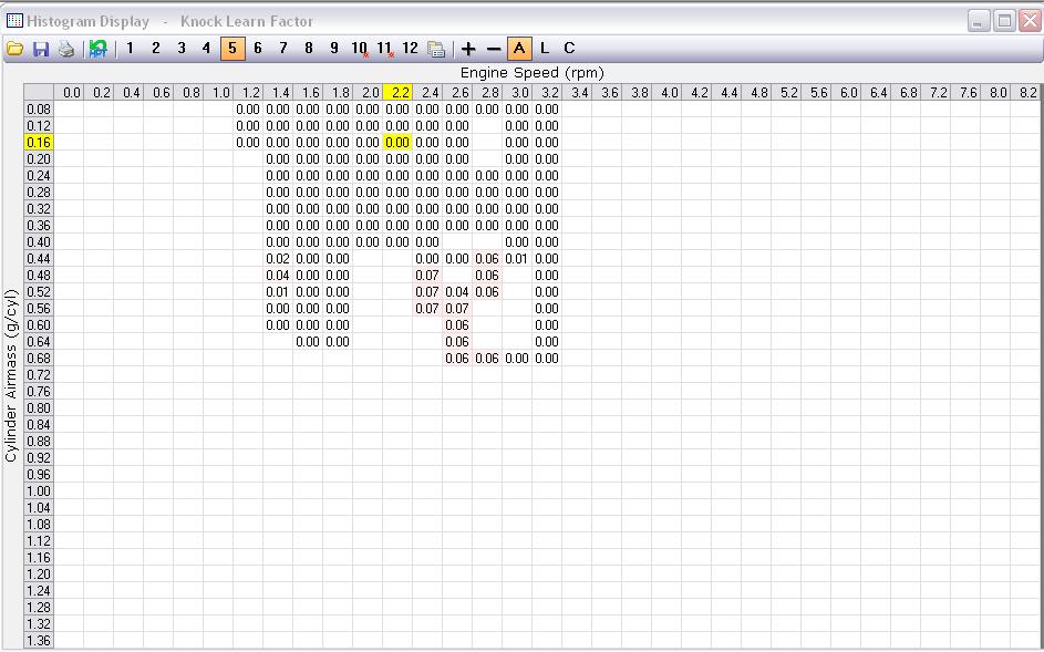

I just got back from setting my HPT to do standalone datalogging with Knock Learn Factor as an additional PID. I like the standalone since it allows me to easily do and save multiple scans both on the way to work and on the return trip then download later in the evening. I also created a Histogram to show the KLF at differnet rpms and cylinder airmass.
Since I go through a tank of gas every 4 - 6 days this test should take long. I'm only on a half tank now so Wednesday morning it will be time for more. I'll add a half tank of 87 and do some scanning, when that runs out I'll go back to 93 scan and see if the KLF is able to change it's reference to the low octane table.
If the ECM isn't able to regain timing on it's own what steps do you think would be nice to see? Pull 5 and 20 and put them right back and scan. Pull

2. 5 & 20 fuse pull...roll ignition over

Your question is a good one about forcing the ECM to use the lower table. It would be interesting to know what parameters are being used to determine that the knock occuring is because of low octane. Remember it uses both tables, it is just how much each is referenced. Which begs the question, when does this get stuck on the low octane table and not able to start referencing the high again? When it hits 100% or what I'll assume for now is 1.00? I've been running 93 octane for 43k miles and my scans showed all hit cells as 0.00 KLF with no KR.
