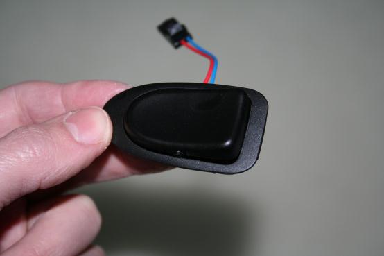

First thing, why buy a new steering wheel when you can just replace these small plastic housings at $17 ? (See picture below).
To fix this, you simply make the connecting part of the aluminum Paddles a little wider, this makes the hinges further apart and will alow them to hold through a little deeper in those plastic housing holes. Using 2 priers, place them right next to the hinges and pull opposite directions to make it like 1 or 2 mm wider. (see picture below).
I haven't seen so far any broken housing. When you look at the 3rd picture above of " aabreu09 " it is only scratched from the bottom and this will be a very simple fix.

Cool, thanks for posting! That makes sense! Question tho...what's with the second pic of the factory paddle? What are you showing there?
[Edit]. Never mind...I'm assuming that's the $17 part? Is it easy to make that plug connection?
