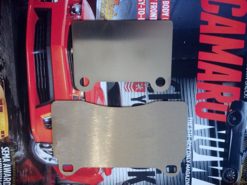

Our fronts 4 piston pots are the same as the CTS-V rears right?
If so these would work to keep heat down in our pads, right?
http://www.girodisc.com/Girodisc-Rea...-V_p_6234.html
Plus, this rebuild kit would be better than the OEM rubber ones?
http://www.racingbrake.com/Boots-and...-p/bc-42bs.htm
Of course I do not see the stainless steel pistons.
I am going to make some phone calls on Monday to see if these will work.
Thoughts?

The notches reduce the conact area and therefore reduce heat transfer. The Brembo GT-R (not a nissan, GT Racing Brake Kits) do it this way.
Brembo takes it one step further and machines in air ducts to that flow air through the holes. I have seen the data on the Brembo system and it absolutely works. The RB notches I would think would help some. The back plate for the pad should be thick enough to carry the load evenly, I think.
The titanium insulator will make a difference, but are not a replacement for brake ducts.
Just my HO.

I talked to GiroDisc yesterday and they now have a Section for us, Ti Plates, pads, rebuild kits, etc.

T, here's another place I found for the titanium plates up in Naperville. They sell them various thicknesses. http://hardbrakes.com/index.php?main...products_id=30

Just got my Ti plates in the mail today from Hard Brake. They line up perfectly with the pads.
