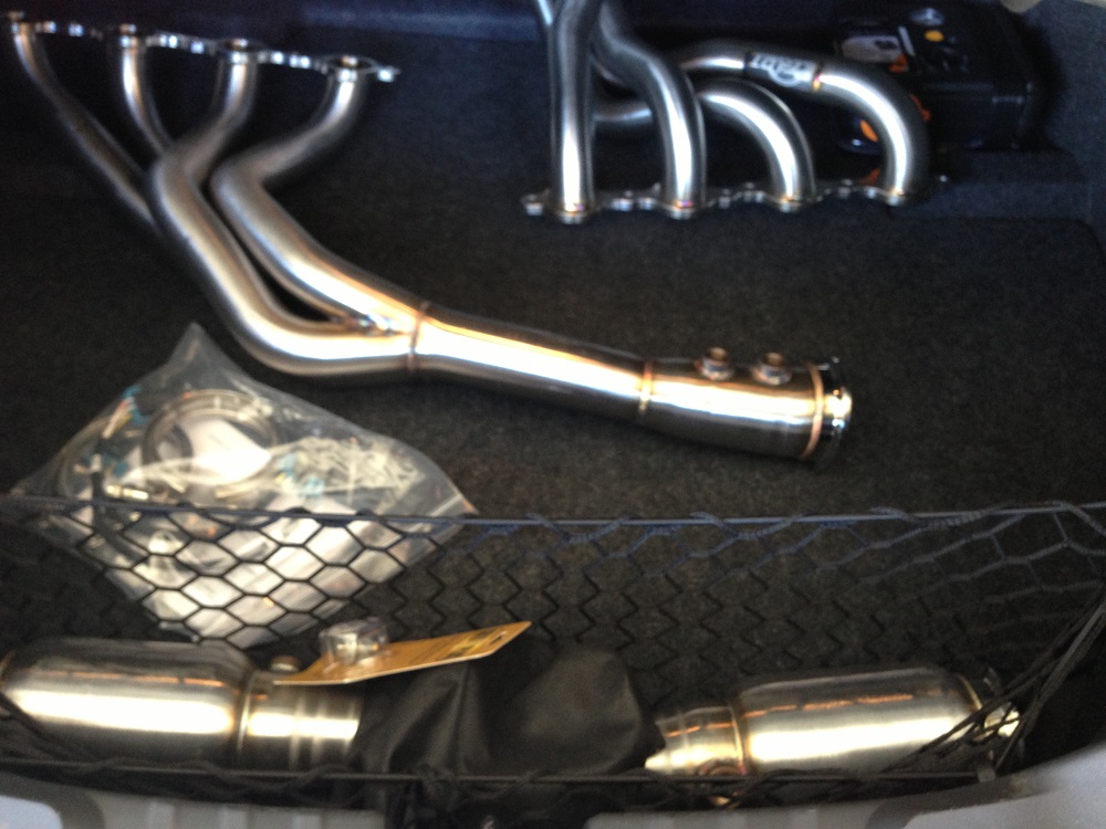

To the Shop: Cam, trunion bearing kit, pushrods, springs (retainers…..etc), ported throttle body & high flow oil pump. While there they also installed some parts I had: headers, hi flow cats, magnetic engine drain plug and the scoop/washer bottle. Then they did a longevity tune
Here are some of the goodies in the trunk the night before, ready to be installed

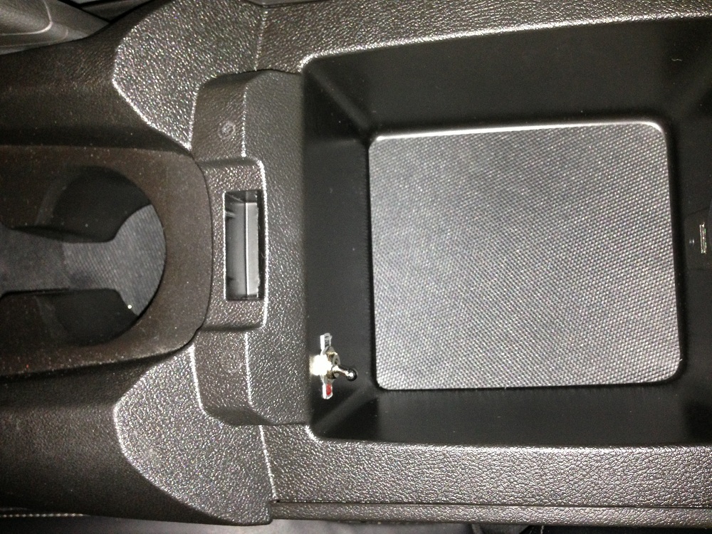

Eighth mod: I got with my son Jason over lunch one day and we came up with a plan to add a relay to make the NPP either quiet all the time or run with the factory settings. One day’s labor and I could remove the safety wire holding the flaps closed. i do need to put in a nicer looking switch............
Details of the mod here: http://www.camaro5.com/forums/showthread.php?t=318683
