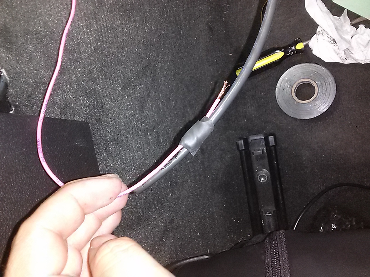

Ok started playing with wires today. Had to undo the pink wire from the loom in order to get enough distance since the battery is in the trunk.

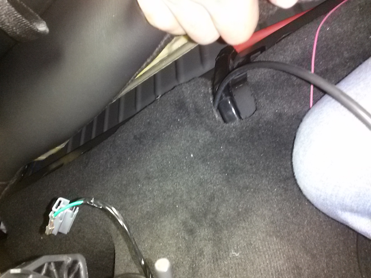

I fed the wires for the remote under the seat and through a side opening that runs parallel to the main positive cable (red wire) I then ran the remote along the plastic kick panels to just under the driver seat.
I opened up the back of the console to access the green wire. If I have to run a 3 amp fuse I see there is enough room there to place it but I was debating if I should just have the 3 amp fuse further back on the pink wire say under the tank and compressor?

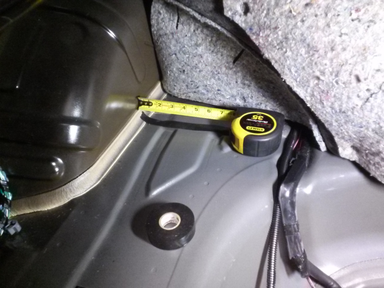

So I was not able to go through the fuse box on the rear quarter and see which is constant power either RSV or RSM or another says CAM I think. I would feel much safer putting it here for quicker access.
Tips anyone? I am off to work so I will check in on thread to see answers and if some of you other guys could snap a few photos or post them up I would appreciate it.

How to tie into this green wire....
tooheysmax is offline   Reply With Quote
