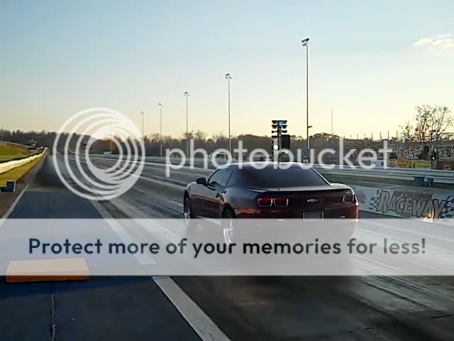

Ok updating everyone on the car. Parts currently on are as follows SLP TVS2300, 3.6" pulley, Texas Speed blower cam, BMR trailing arms, Fastlane Inc CAI, 160* tstat, slp loudmouth 1, ARH longtubes, aem wideband, aem boost gauge, 17" bogart racing rims, Mickey Thompson drag radials,AEM Meth injection, spec twin disc clutch, boostedyards toond. With this combo it put down 588whp and 566wtq on a local mustang dyno. It also propelled the car to an 11.3 at 125 on the stock and slipping/burning clutch on a 38* day with zero track prep (it was a motorcycle only day and I had permission to run).
vid of said run.

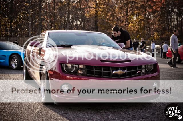

What a piece... We pushed this thing to a faster ET then it could manage at MIR...

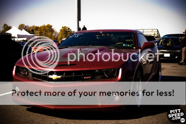

Old 04-21-2010, 01:07 PM   #24
That Camaro looks awesome

Thanks man I really feel the stripes bring life to the rjt color. And matt shush. Clearly I pushed a lil too hard.
