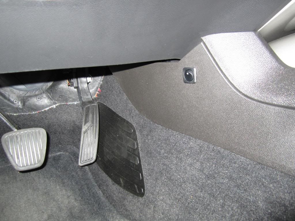

My solution to Mild to Wild. I just hardwired a switch. I leave it off (open) most of the time. I switch it when I am crusing on the freeway. It drops the cabin decibel's while on a long drive. No batteries to worry about.
"Just". LOL. Do you realize the cold sweats most of us 'shade tree mechanics' get when you mention cutting wires?
Nice, clean installation by the way.

I believe a 3/4 inch drill bit made the perfect hole. just make sure you place it where there isn't anything blocking behind it. If the switch was any higher or to the right it would have hit something. the most difficult thing was to fish the wire under the carpet from the back seat to the center console
