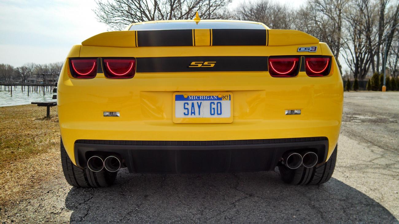

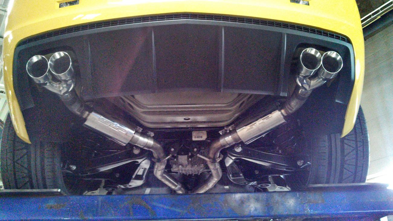

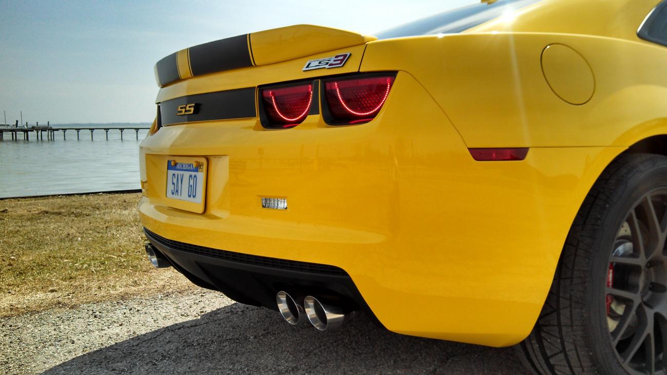

Originally Posted by TommyTheCat View Post
Ok I so I have my 1LE exhaust diffuser ready to install. I'm running magnaflow axle back exhaust on my LFX, which the piping is pretty close to stock since it was direct fit. The piping is 2.5", but of course I need to change to quad tips for the 1LE diffuser.
I see these posted around but their examples show no 5th Gen Camaros... will these fit? Do i need them to be smaller in length? These are 11.5"... I'm afraid it will stick out too much.
Does anyone know where to get good direct fit tips for 1LE diffusers?
Here's what I'm looking at, interested in 2.5" inlet 4" outlet.
http://tips.byethost4.com/dualindividual.html
Thanks!
-edit-
these look like theyd work but they're only 3" outlet. anyone know if there are 4" available? and theyre only 10" length... does that mean the others are too long?
Take a look here. I recently went through the same thing. Very happy with the tips.
http://www.camaro5.com/forums/showthread.php?t=343362
newagemuscle is offline   Reply With Quote

Newage, what part did you have to fab up? I am having my quads welded in this week. It would be nice to give the exhaust guy some direction ahead of time.
Nobody with a good car needs to be justified. -Flannery O'Connor
Pathogen is offline   Reply With Quote
Old 06-12-2014, 05:28 PM   #20
newagemuscle
Philippians 4:13
newagemuscle's Avatar
Drives: SLP Supercharged LS3
Location: The Motor City - Michigan
Posts: 2,902
I had to have the outlet pipe cut back an inch or so because these tips were longer than my SLP. He also heated the hanger and bent it so it would utilize the stock isolator. My old tips bolted on, so with these they had to be welded. Also, take note if you get the 2.5 inch outlet... they were actually a little larger, so make you exhaust guy aware or either have him measure. My guy worked some magic to make it work perfect.
