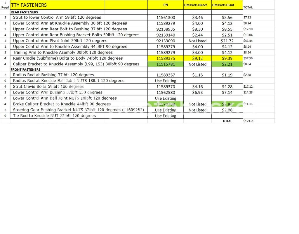

Posts: 894
Here is a list of the TTY's (ref - this list is for a 2010). You can reuse them a few times, at your own risk. All can be purchased from GM Parts Direct or GM Parts Giant.
hesster is offline   Reply With Quote

Posts: 124
First, a true TTY bolt, that has been torqued-to-yield, should absolutely only be used once... A TTY bolt, that hasn't been torqued-to-yield, can be re-used just like a non-TTY bolt.
Where did you find that list, and what does green designate?

Posts: 894
I made the list when documenting the build of my ride. I researched the listed GM Parts websites to obtain and order the correct bolts, and all were correct when I did my build last year. The colors do not have any significance. To me, it was cheap insurance to buy all new fasteners - peace of mind for $175.
