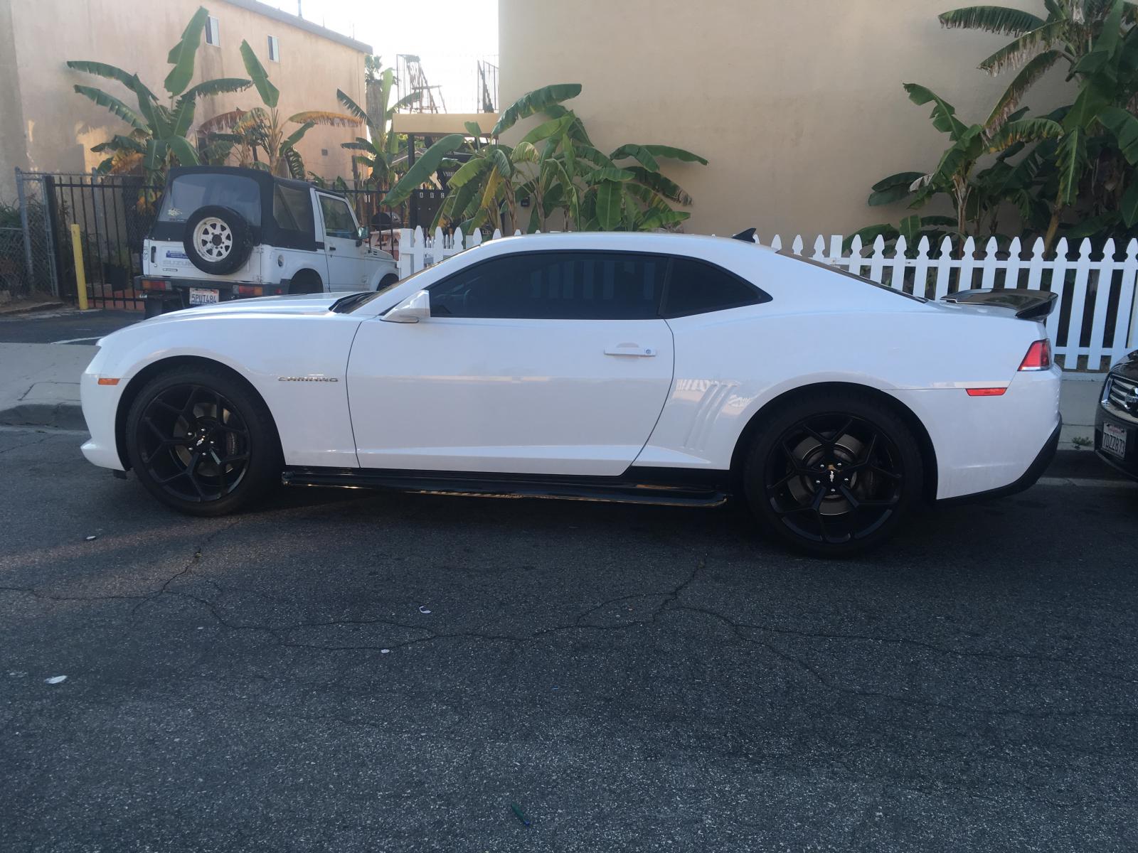

I literally just installed mine. It was MUCH easier than I thought it would be. I got them painted all black though, check out the pics of them on eBay so that you get em done right. They still look bad as hell though! I love them.

Name:  Camaro profile.jpg
Name:  side skirt 1.jpg
Name:  side skirt 2.jpg
Name:  side skirt 3.jpg
Name:  side skirt 4.jpg
erickangulo is offline   Reply With Quote

how do the edges of the skirts look up close without the z/28 fender flares attaching to them? it's hard to tell from the pictures.
looks great.

I don't have the fender flares on mine, because my tires aren't wide enough. The rockers look great without the flares though. Someone said that they would look off, but you can barely tell, if at all.
