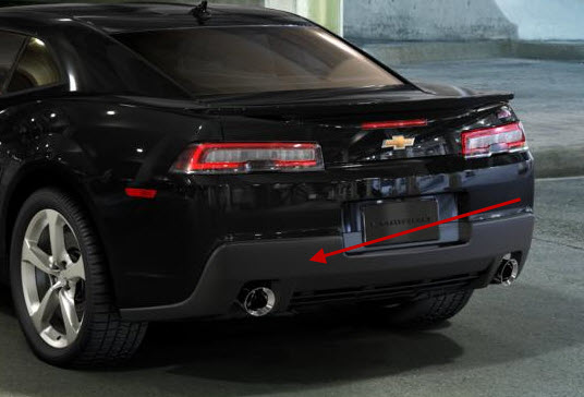

This is essentially my rear end. I will not be able to get quad tips without replacing this piece? Correct?Name:  RearEnd.jpg

Originally Posted by zissophiss View Post
This is essentially my rear end. I will not be able to get quad tips without replacing this piece? Correct?Attachment 699907
Correct. You also cannot put quad tips on the stock exhaust becasue of the length and position of the outlet pipe.
Well, you can but there will need to be moderate modifications to your exhaust, like possibly moving forward/back the mufflers, adding pipe to the back end or something of the sort. A good Muffler shop can get it done.

Quad tips Q's
Actually you can't as the is no room to move the big cans forward enough to fit the tips. But if you somehow fine a muffler shop that "could" (which again I say cannot be done) fabricate something the cost would probably be more then buying a new axle back.
So I'll stick to my answer that quad tips cannot be added to the stock exhaust.

Originally Posted by bluebonn View Post
One question I have the MRT version 2 installed currently. Can I add quad tips as long as I get new diffuser on 2014 LT/ I believe the current tips come welded on
If this is what you've got, then adding the tips would be no issue. Just have to get the right diffuser... I believe the part number for the NPP for your year is as follows:
22829477
Its just pipe, cuts and welds. It would not be expensive at all to modify an exhaust to make it work. After seeing my guys work, I sincerely believe its possible and that it wouldn't cost that much... but, your call.
Yea the MRT v1 come with tips on them as well which are a downgrade from the stock tips that come with the 2014 camaro. Im just gonna take it to one of my buddies shops and let him do his thing (always turns out great). for the diffuser you can get the 1le or zl1, I chose the zl1 because I plan on adding some skirts and the zl1 diffuser matches the skirts. It also has heat shields where your tips run through which add a little extra to the looks But with anything its all preference.

Originally Posted by Harrisonda09 View Post
I am in your same vote. Just got the MRT V.1 and the diffuser. Note: the diffuser for the 2014 is held up by 10 star T15 bolts, the rest are just snaps.
Below is the diffuser with the MRT V.1 installed just got the tips in from http://tips.byethost4.com/dualindividual.html. I was worried about buying the tips from this site but it seems everyone is going with these because they are good quality and staggered (Pic below). Received the tips in less than a week and they sent me a tracking number immediately. I am getting everything welded up on Friday. Will post more pictures then.
PS: I went with the 2.5" inlet 4.0" outlet.
