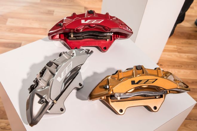

I'd like to look into whether the 2016 CTS-V Caliper and 15.4" rotor will bolt on. It is too new to dig up part #s unfortunately.
2022 1SS 1LE A10 BCD WCT+PDR2014 1SS 1LE NPP RECARO SIM-SOLD1995 Z28 M6 GSC PGM-SOLD1975 NOVA COUPE 300HP 350 TH350 FLASH RED-SOLD
"KEEP THE FAITH"-Fbodfather

The big V Calipers will fit but the rotor has a different offset than the zl1 rotor. By the way all part numbers are released and in service,
