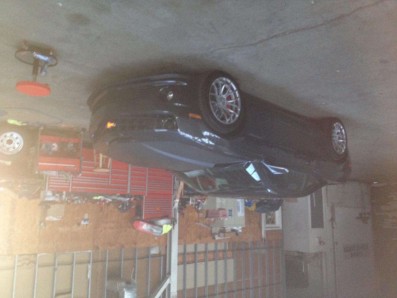

Here is my 13'.
I took delivery back on Jan 3,2013.
Drove home and off came the GY SC2 til warm weather
On are
19"/9.5" Breyton Race GTS-R, and
275/40r19 Bridgestone RE960AS RFName:  IMG_1727.jpg
