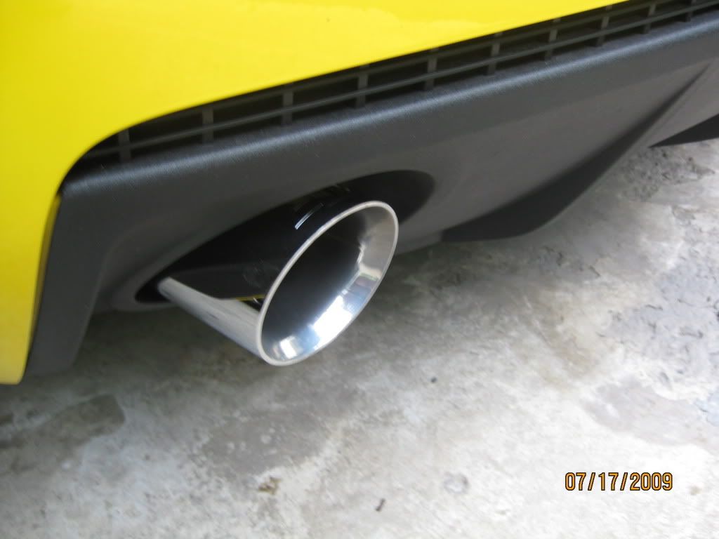

i kno there are two seperate gmpp kits on for cars with a ground effects kit one without. did u have the right kit?
Yes, I have the correct one. The one for use with the ground effects kit doesn't include the exhaust tips.

I have the v-6 version of the GMPP exhaust. The dealer installed them and I asked that tips stick out as far as possible. Not much play for that because of the hangers but more play inward if the existing pipe is cut a little short.
No problems here.

Originally Posted by JM10 View Post
You´re not going to believe me, but I have an appointment with an exhaust shop in 30 min.
I got my magnaflow installed yesterday but tought that the exhaust tips where sticking out of the diffuser to much (about 1")
This is the look I want:
(Soloperformance)
That is my car............and that is how they should be installed!

Those tips are in way to much

Good thing it's just the diffuser and not the paint. Looks like the exhaust is sitting in a little to much

looks like a installation issue to me. Mine stick out a little also and no issues at all.

FYI everyone,they are TOO far in

exactly looks like they are too far in the tips dont get as hot as the gases coming out so that is why it would have melted

well yeah plastic will melt when a hot metal tip sits against it. looks like your tips were too far back. and probably not centered with the hole.

Wow, that is one hot exhaust. definitely way off center and too high. look at the difference between your exhaust outlet on the drivers side and the pics from my post with new Magnaflow (close up pictures toward end of post)
http://www.camaro5.com/forums/showthread.php?t=46588
