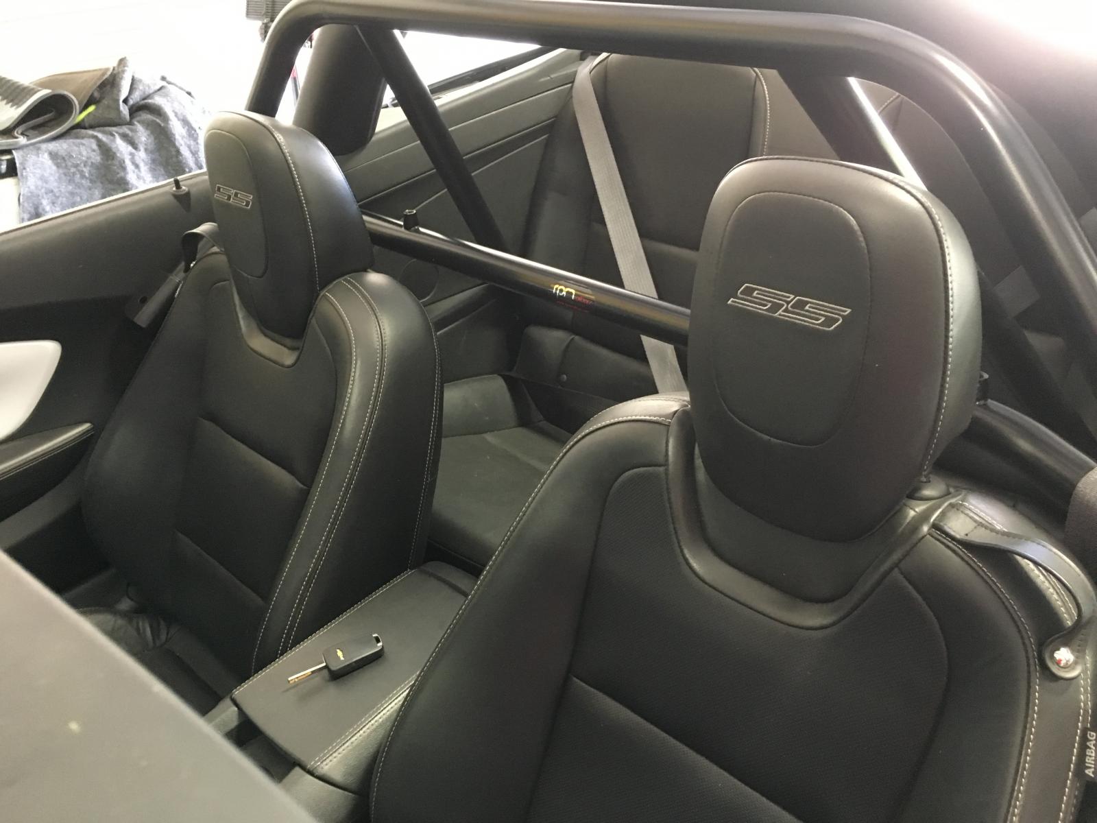

The motor is still not done so I decided to bring it home and install the RPM roll bar while there was some downtime. It was a little difficult but nowhere near the effort i can imagine if it were a coupe. The directions weren't the best to say the least but one can figure it out. In the end, it turned out really nice and fits very well. Now if i could just get the engine back i can get the 416 built motor, 6L90 conversion, new driveshaft, and triple disc converter and should be back in business.
