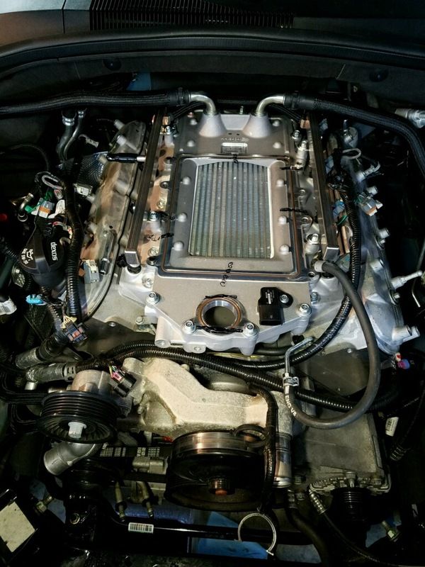

And now for the cherry on top! or in this case the Supercharger!!
The hoses get attached now. At this point, the guys are looking to see how to best run the electrical wires to be out of the way and look good. Also to take note of where the hoses are and how best to run them so they are out of the way and look good also.

One suggestion if you've not done it -- upgrade the Bosch pump for the varimax -- get the pnp harness -- you'll be amazed what additional flow does for the PD blowers...

Intercooler pump?
